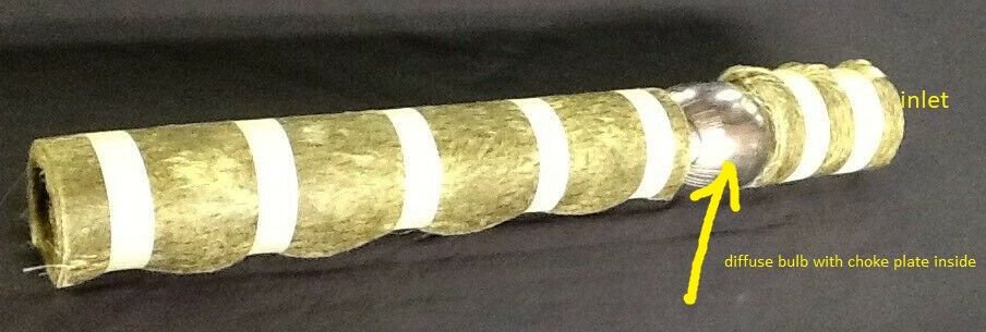

Depends on how much and which end you're packing, plus whether you have a diffuse plate. So, if you're doing a straight thru perforated tube, fiberglass is fine. Ceramic does hold up to higher heat for longer if you're doing a muffler that has an expansion bulb in the baffle tube. Only downside is ceramic costs more but it will outlast fiberglass many times over.
Here's a photo of a brand new (old style) Screamin Eagle (Kerker) touring baffle. The fiberglass on the inlet won't be there for long, at all.
On mine, I used ceramic on the inlet end to the "bulb" and left the rear section bare. My mileage went up nearly 7 mpg with no other changes. I pulled the baffles out after about 6k miles and the ceramic packing hadn't degraded at all.
