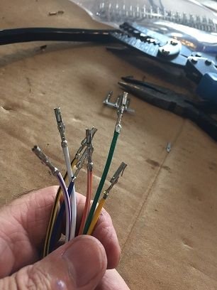

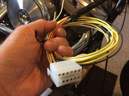

Are the wires on the switches long enough to reach the original connection point?
You can use whatever connector type works best on your bike, I recommend staying with whatever was original equipment, I think your bike came with AMP Mate n Lock connectors.
You can get the parts from a zillion online electrical supply places, but the easiest way to get a few terminals and connectors is from Namz.
Namz Custom Cycle
All you need to do is crimp the terminals onto the wire, and install the terminals into the connector.
Wires from switches with terminals installed, ready to install into connectors.
Wires installed into AMP Mate N Lock Connector.
