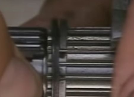

I see in the other thread, better pics that that thrust washer does look broke

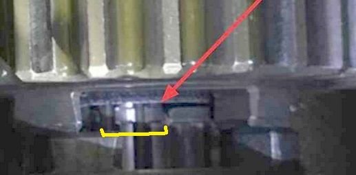

Yeah, Max got a good eye but the thrust washer is next to the gear and intact. The gap at the red arrow is the lock ring end(s) which looks like the correct space.

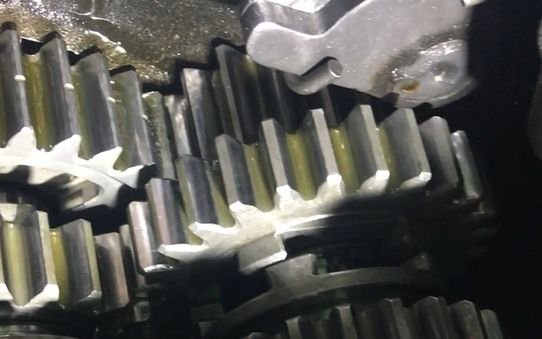

Also, the counter shaft looks to be at correct depth since the 5th gear idler is fully meshed with the main drive gear. Looks that way to me.
Captscotty, do this - take the clutch cover off and with the handle of a hammer, give the clutch hub a good hard bump or two. I'd wager the main shaft will slide to the door side enough that everything will look a lot better for you. Then knock the roll pin/dowel out of the trap door and put it back in the transmission housing where it belongs. Finish up the job...
