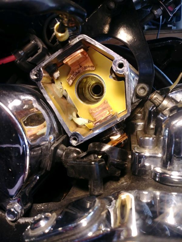

Yep and once you do one (I guess depending on the bike)
you can do it on the side of the road if you had too.
Don't lose the chrome ball when you pull out the plunger.
The videos I watched about it didn't even mention it.
No greasing anything inside either. Clean and dry.

One of the contacts you need to replace is in a very tight area, not sure it will be accessible with the starter installed on a Softail.
Yeah, it is a pain to remove the starter on a Softail.
The best way that I have found to remove the oil tank is to remove the rear wheel and the fender extension that goes behind the oil tank area. This will make the oil tank easier to remove.

Not sure about other models but for my Electra it wasn't bad.
Just need to get the end cap open and disconnect the battery.
I bet most the bad starters are really just bad solenoids.

I vote for changing the entire unit.
Problem with replacing the contacts is that often as not, the reason they get funky is that the electromagnet gets weak, not making a quick, hard, solid connection.
The electromagnet is an integral part of the assembly for which there is no longer a replacement.
