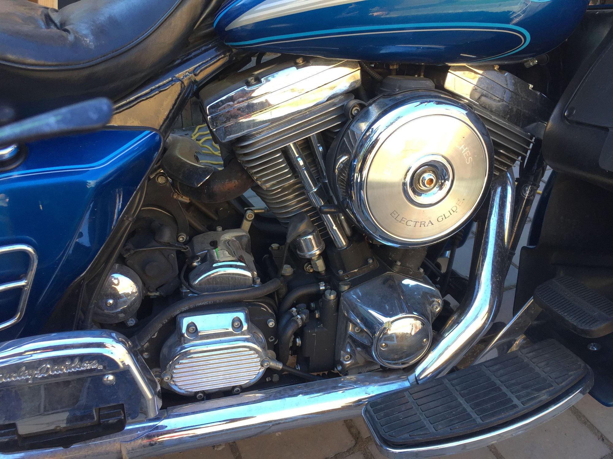

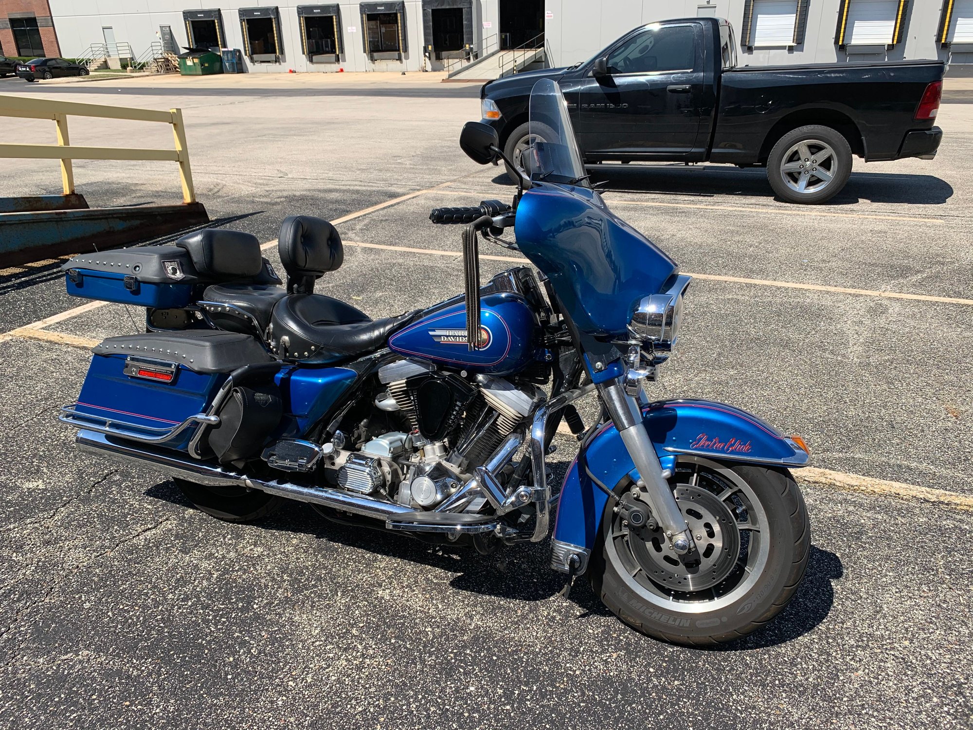

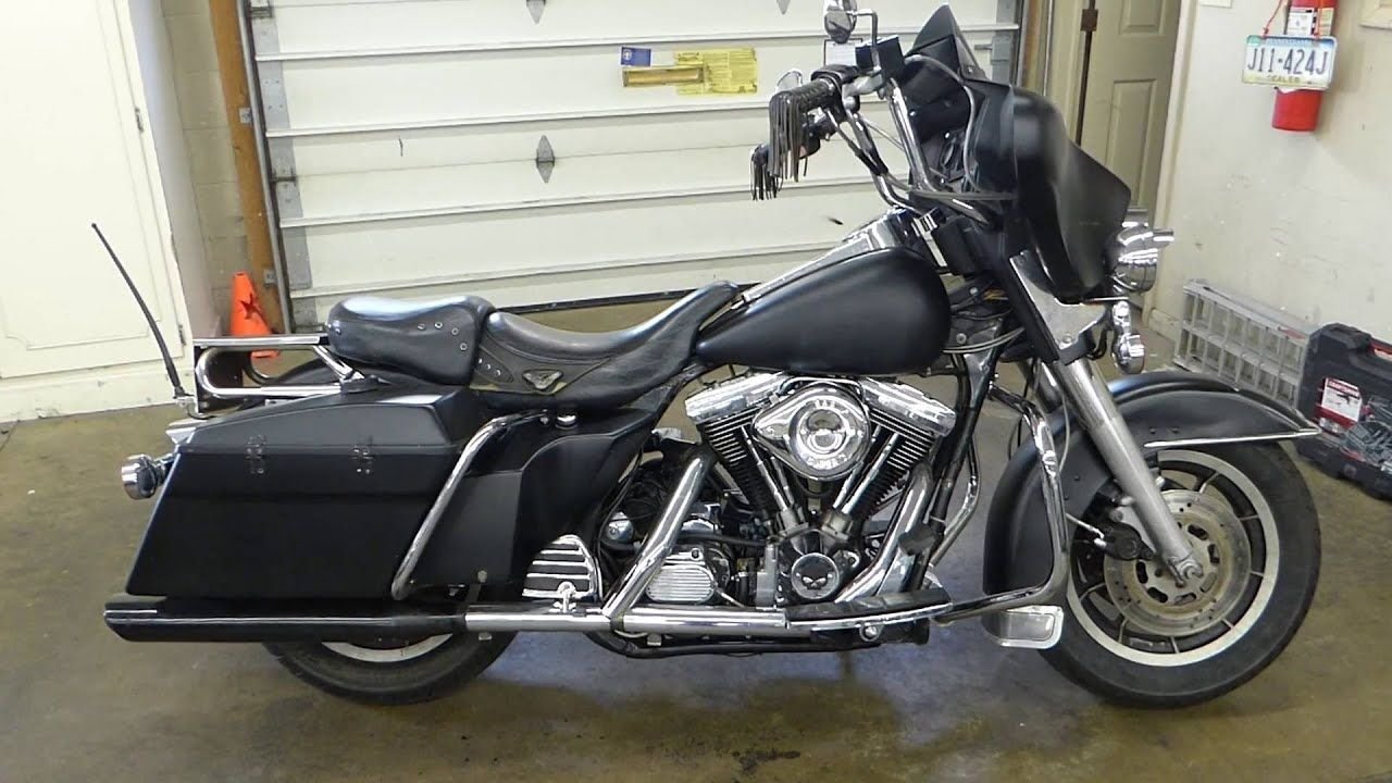

Hey all.
Can anyone tell me why the exhaust is on the blue ultra is missing the rear crossover? Is this a system from a a different year? It does have 65539-95a mufflers on it but all the 1995's I look at also have the crossover. The black bike is for illustration purposes.
Thanks, Frank

Has the Fullsac kit making it a true dual. Mine does too.

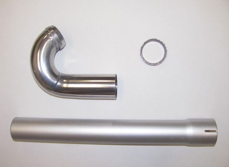

This Fullsac kit (top pic) for 200 bucks was bought to remove that crossover piece, the second picture, making it a true dual.

On bikes this age it's tough to find one that hasn't been modified by a previous owner. I'm a little surprised it has HD mufflers, with a mod like that you'll usually see an aftermarket muffler.

Most of those Y pipes have cracked that’s why they go with the true dual or fulsac conversion. That’s a nice piece for an early dresser.

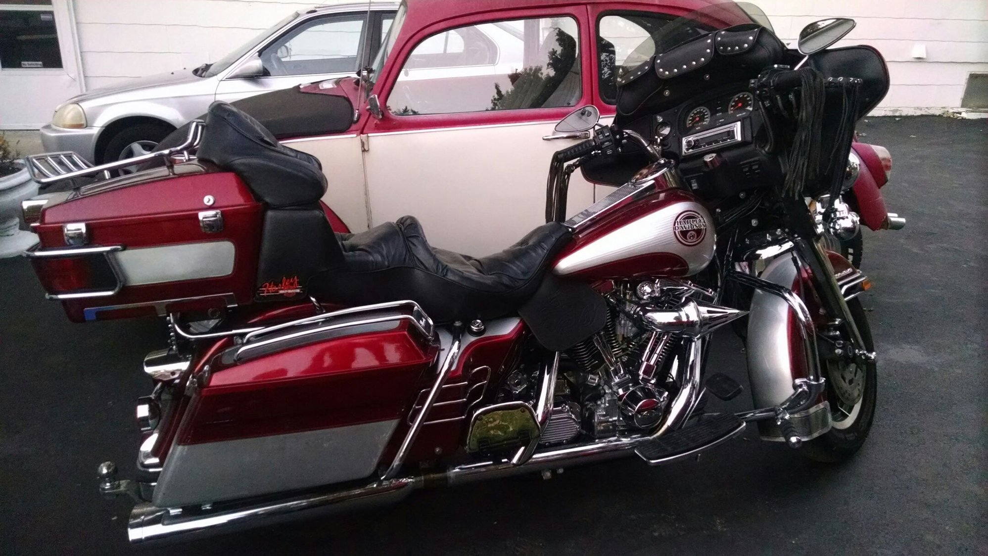

Mine is as good as it looks in that picture I posted here. No cracks, no dents, no issues.
I just did it for the true dual thing, which honestly I can't really tell a difference.

OK Ray, I missed it the first time I looked - was the Bug painted to match the HD or the HD painted to match the Bug ?
