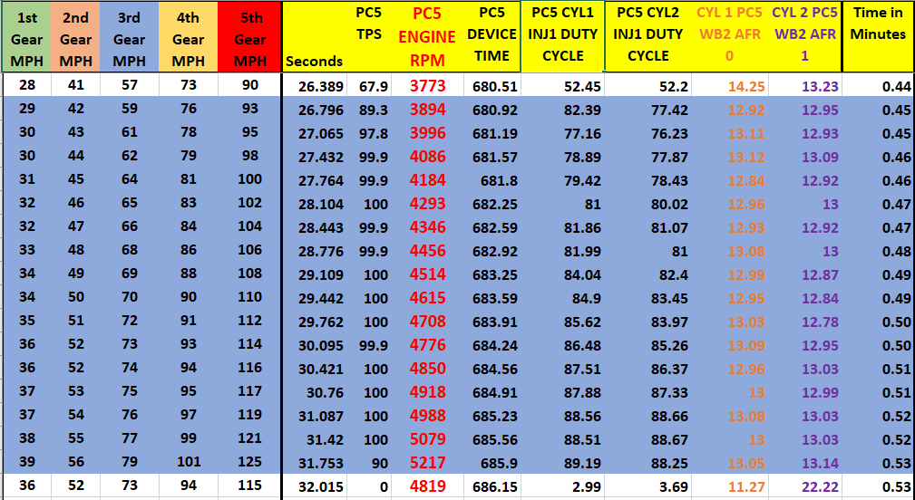

I was out on the 96 EVO today and made a couple of runs to redline in 2nd and 3rd gear, came up on traffic in 4th and didn't get to redline.
It is on an XL spread sheet. At 5200 RPMs at 90% throttle, the injectors are at 89% on the front cyl and 88% on the rear cyl, I'm thinking about some higher volume injectors.

You have a pretty good tune there.. Don't get what makes you think you need different injectors??
I don't really need new injectors, after thinking about it, it is fine right were it's at. I did bump the rev limiter at 5305 rpms in 2nd gear, but in normal riding, I don't get over 4000 rpms...

Those numbers look real good, red injectors are included in a Evo Screamin Eagle package and stock in the Twin Cams, would be all you need if you wanted a upgrade.
All the tuning was done by the dynojet auto tuner.
