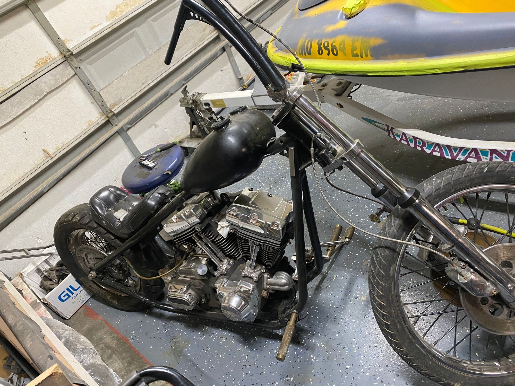

To start off with, this is my first HD. I’ve had Kawasaki’s, and yAmahas so no stranger to turning wrenches on a bike. Picked up a project from my boss.. he was told when he got it, it was a’99 evo. I’m just trying to confirm so I can order the right wire harness for it and go from there. We work in the towing industry so frame numbers are no help do to fact it’s a scrap frame.

Nope - it's a Twin Cam

Pic of engine # please ( Left side of engine where the cylinders converge)

If nothing else the space between the lifter blocks screams Twin Cam

I hate guessing from pics, but that looks like a right proper mashup right there.
Clearly a twin cam bottom end, but are those early-Evo bottom breather heads? The carb mount holes look "bottom breather" small to my eye.

Can you use T/C rocker boxes on an Evo ?
Asking not challenging
No. Only thing off a TC that you can use is the early exhaust, oil coolers, and carburetor. The rest of it goes in the scrap heap with the disposable flywheels....

FXDWG 88" TC motor.
