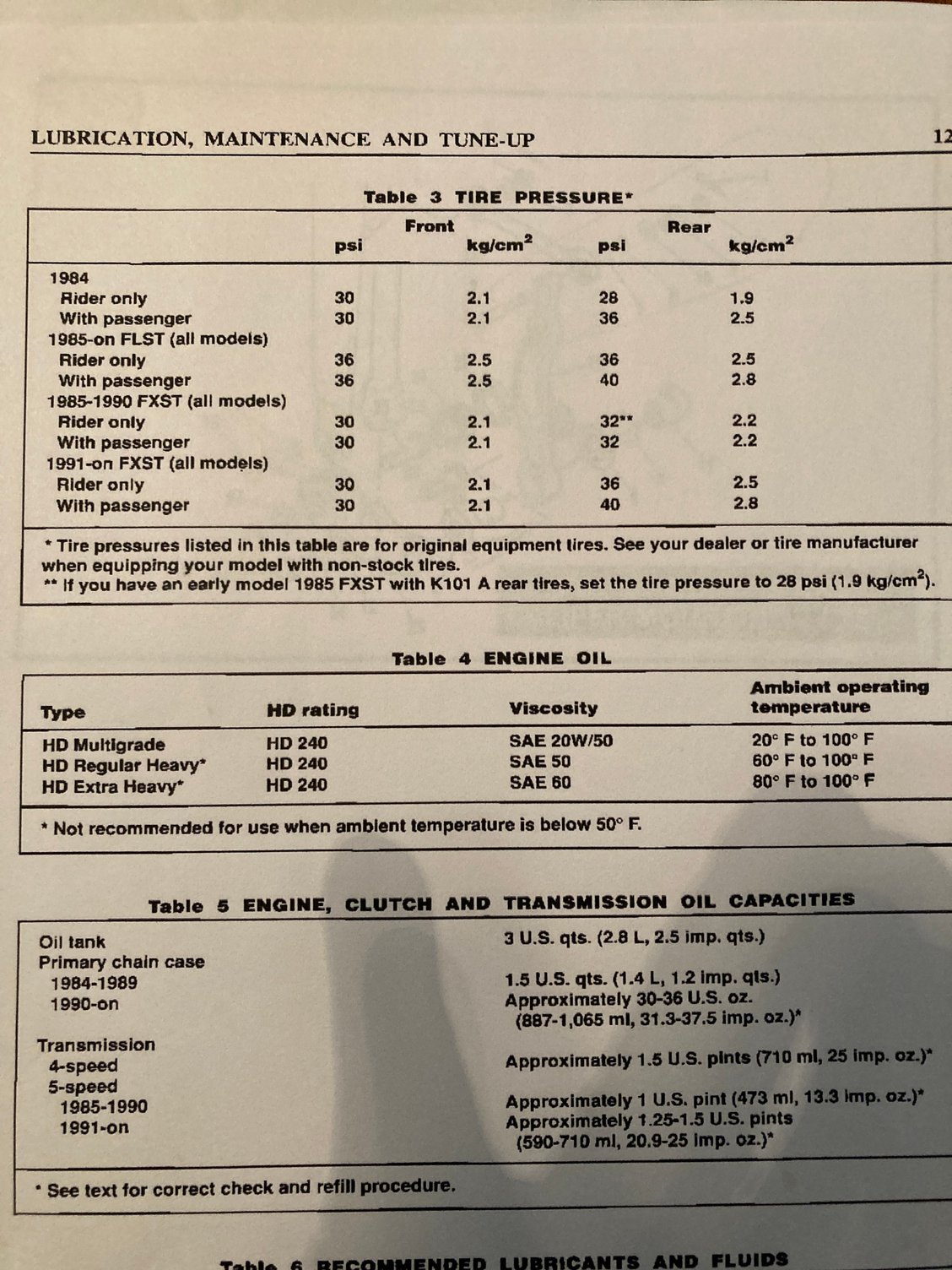

Took my recently purchased 93 out for the first time a couple days ago. It was a warm day but I wouldn't consider it super hot. I noticed when I stopped it was showing zero pressure and the idiot light came on. I let it idle like that for a couple minutes and didn't hear anything unusual so started rolling again and pressure went back up to between 20 and 30 and no noise on the 10 mile ride back to the house. The dealer said they did an oil change on it when it came in and I'm assuming they put 20-50 in it. The odometer shows just under 16,000 miles but who knows with a bike that old? I think I'm gonna go ahead and do a oil change and put straight 50 in it and see if it holds pressure when it gets hot. The FSM recommends straight 60 for hot temps though.
The FSM does not recommend SAE 60 for hot temps, it simply approves it, (beside that, thicker oil is not a cure for low oil pressure in any engine).
If you are not hearing lifters clattering, the engine has sufficient oil pressure, all the engine needs is about 6 PSI at idle...
Low oil pressure reading on gauge when hot is normal, if the light is coming on, suspect a bad oil sending unit.
Old Jun 7, 2021 | 08:37 AM
IronAss's Avatar
IronAss
Posts: 23,053
Likes: 12,327
From: Arkansas
Originally Posted by Dan89FLSTC;[url=tel:19978733
19978733[/url]]The FSM does not recommend SAE 60 for hot temps, it simply approves it, (beside that, thicker oil is not a cure for low oil pressure in any engine).
From the FSM.
