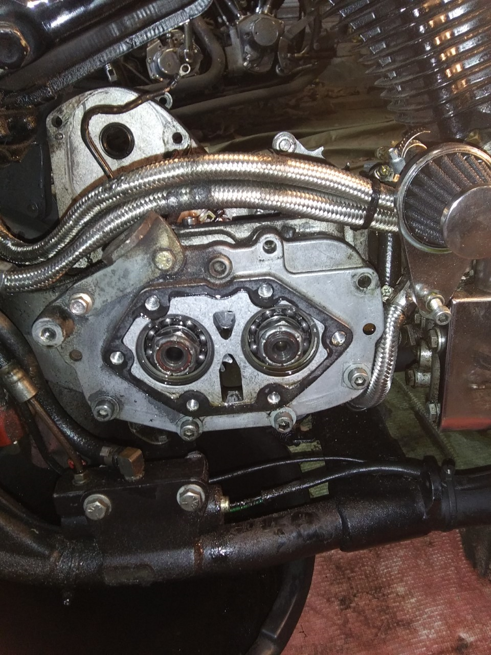

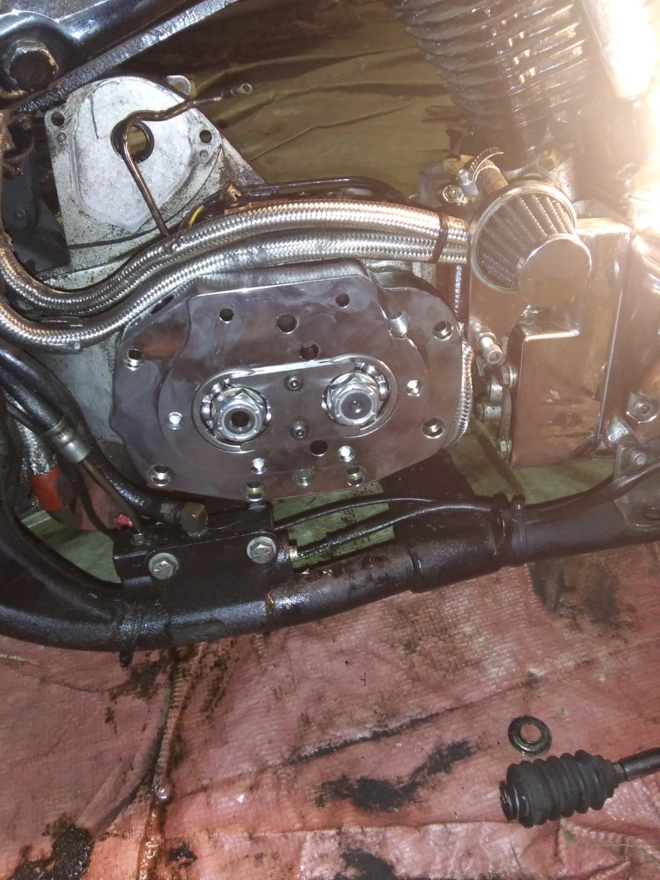

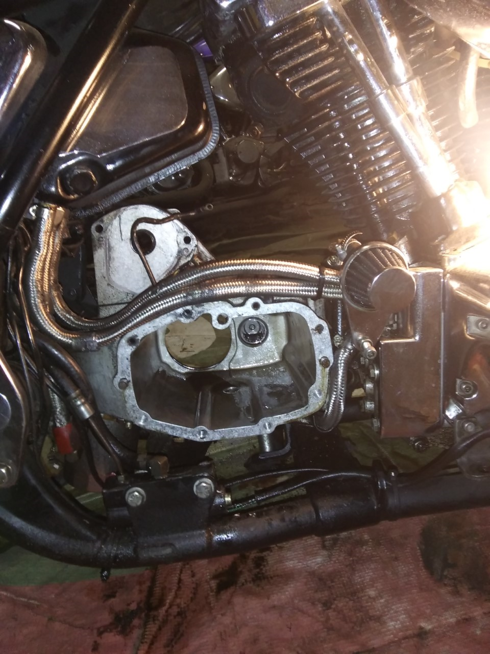

But if you really want to upgrade the bike this winter because you said you want to get rid of the clutch too, This is what you do, I've done this to my bike, other buddy's bikes, and helped one friend here on the forum, the newer 5 speed gear sets will fit in your transmission case up to 2006, but Id start at least 1994, better bigger trap door bearings, you can find nice used newer style gear sets, with trap door, and better newer style shift drums for like $250-$300 on ebay, then your main shaft will be upgraded to a spline shaft 1991-2006, getting rid of your tapered main shaft, clutch primary use 1991-1993 style then you can use your same starter and primary covers, 1991-1993 stock clutch primaries are not the best but Barnett makes a good one for these years, my friend that I helped here on the forum has his all back together and he says it shifts like butter and easy to find neutral, I did all this to my 1985fxr the only difference is I put an OD six speed in it now I leave twinkies in the dust

Old 1985 5 speed out, new 2006 six speed in
