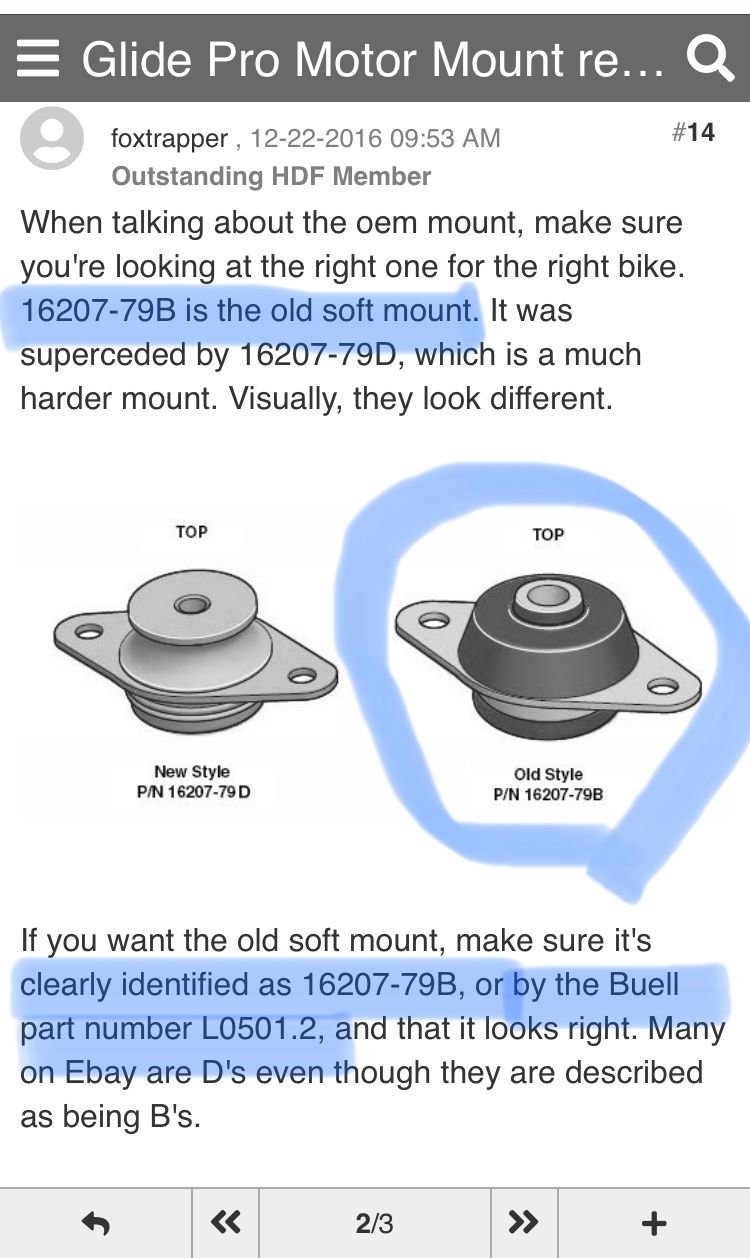

Now for the questions, I heard that there is a OEM BUELL isolator that is a straight swap for a Dyna. Wich year and model of BUELL uses this isolator?
I can get BUELL OEM parts here in Sweden.
Thanks for any advice!

Forgive me, I may be mistaken in thinking you are confused from something you read, but the Buell front mount is identical to the Touring models and is nothing like an FX mount.
There are discussions that come up in internet searches that talk about ordering the Buell front mount that for a while, was the earlier version of the 16207-79 which was still available thru Buell. The thinking was the earlier ones were "softer" with less vibrations. But the current 16207-79(D) is all they have now, to the best of my knowledge. It has a mushroom look on the top side. Again, nothing like the mounts on an FX. Stick with OEM and you will be better served.
Touring model(s) front mount
FX front mount

Default Much obliged.
t150vej, thanks!
Yes, I search the net for pictures and noticed that my Isolator looked nothing like the Buell one.
So, I guess I stick to the OEM version.
Cheers! /Kjell

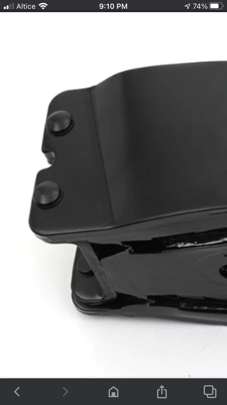

I thought my 1998 FXDL needed new mounts due to increased vibration. The mounts were actually ok.
The rear mount had rivets that pupped out and wasn’t keeping the mount tightly secured. Ended up installing small bolts/nuts in the rivet holes. The vibration was acceptable after that.
Something to inspect on your bike….

Those rivets on the left are what had popped out. Can happen front or rear…..mine was rear.
