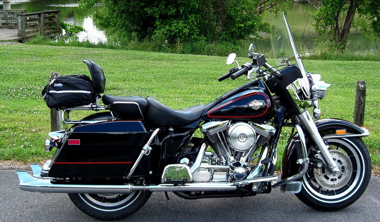

The 1987 FLHC is running perfectly until yesterday when a metallic sound could be heard at low speed. I shut off the engine and it was coming from the front brake calipers. A close look showed that the outside puck on the right side of wheel was missing. I heard it fly off earlier but thought a piece of wood got picked up between the fender and the tire and was lodged there. The rotors are new floating billet chrome and the brake pads are brand new 250 miles on them. I've never seen this happen in my million mile history. Anyone have any ideas why this happened? No warpage (smooth brake engagement) New pucks going on this morning.
