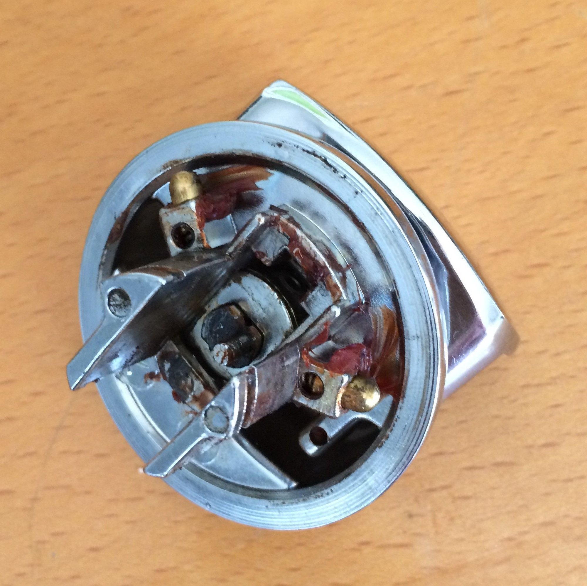

I finally got the ignition key from Harley.........and it doesn't fit.
So I've bought a cheap one from elsewhere and fitted it.......however I didn't want to waste the old one.
I took it off and started to dismantle it. on the base there was a circle with a 7 in it and another one with 97 in it....so I'm guessing it was manufactured in July 97, which would fit for a 98 model Harley?
I am pretty sure it is the original lock, and Harley's records have got it wrong.
Now I dismantled it as far as I can, but can't seem to get the barrel out to see if there is a number on it.
I read that you have to insert the key to remove the barrel.....is that right? if so I'm stuck.
Below is a picture of where I've got to.

A good locksmith will have a tool that will open a barrel lock faster than if you have the key, and leave the tool with the exact pattern needed to make a duplicate key.
