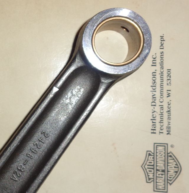

Cylinders pulled at 80K for base gasket leak, noticed a ugly gouge on one of the connecting rods (later explained by a former HD engineer to be a tool mark from straightening the rod in production)................... `
Like this, Dan? Yeah, they tell you in the FSM you can't straighten a rod, yet that's exactly how it's done at the factory when needed.....

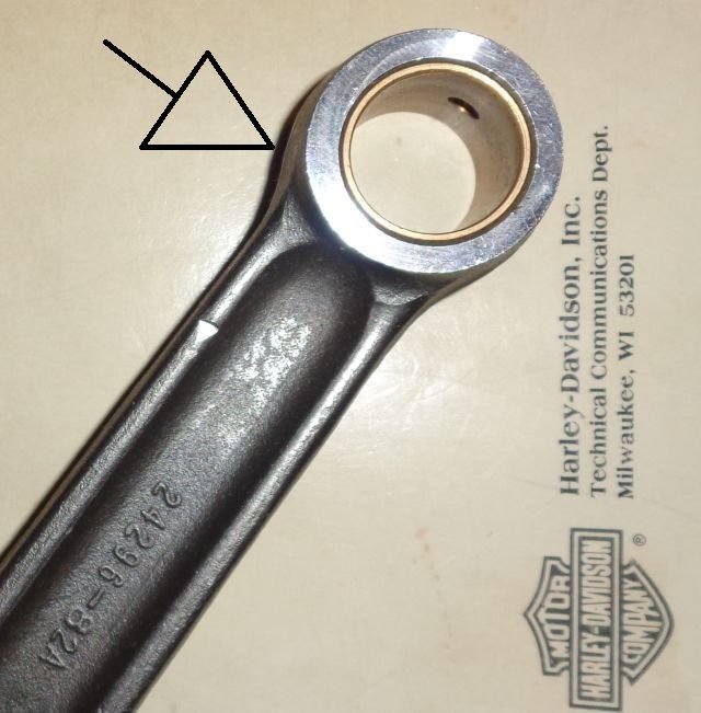

It was in this area, a big v shaped gouge with raised material.
Nothing was damaged inside the engine, so it was not caused during engine running, it was the condition of the rod when it was installed at the factory. It hung on my garage wall for years, but with I retired and moved south, it went into the scrap can.

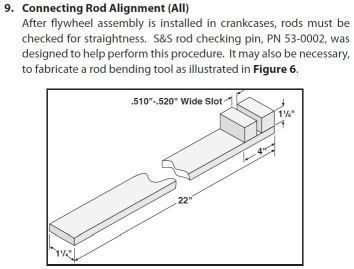

^ FWIW the old manuals for vintage bikes detail the procedure for rod straightening. Yikes !
Yep, and S&S still does - or did. They even gave specs and a photo on how to build a tool. There is a necessary way to actually, physically do it that they don't tell though.
