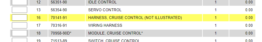

Old Sep 21, 2021 | 09:13 AM
0maha's Avatar
0maha
Joined: Nov 2012
Posts: 6,555
Likes: 4,800
From: Omaha
All I can say is that on my '90, I deleted the radio without incident. Just unplugged it and pulled it out.
One of these days I'm going to get around to replacing my hand controls. I've still got the orphan radio controls sitting there doing nothing.
No idea about the CB or the cruise. One thing to note is the parts fiche actually lists a separate part number for the wiring harness, depending on cruise control.
So who knows.
My guess is you could just unplug the CB without side effects.
If this was my bike, I'd take a stab at getting the factory cruise control working. Assuming you want cruise control, that is.
The problem with cruise control on these older bikes is the mechanical speedometer. All the newer and aftermarket cruise units rely on the transmission mounted speed sensor that your bike doesn't have.
Do you have the FSM and if so, does it have a troubleshooting guide for the cruise? (My manual is at home and I've never looked.) The way I see it, there are four components to the cruise system: The cruise module, the servo motor, the reed switch on the speedometer, and all the wires that connect everything together. The problem has to be one of those, right? Maybe I'm talking out of my ***, but this seems like it should be a reasonably straightforward troubleshooting problem.
Anyway, just some thoughts. Good luck!
