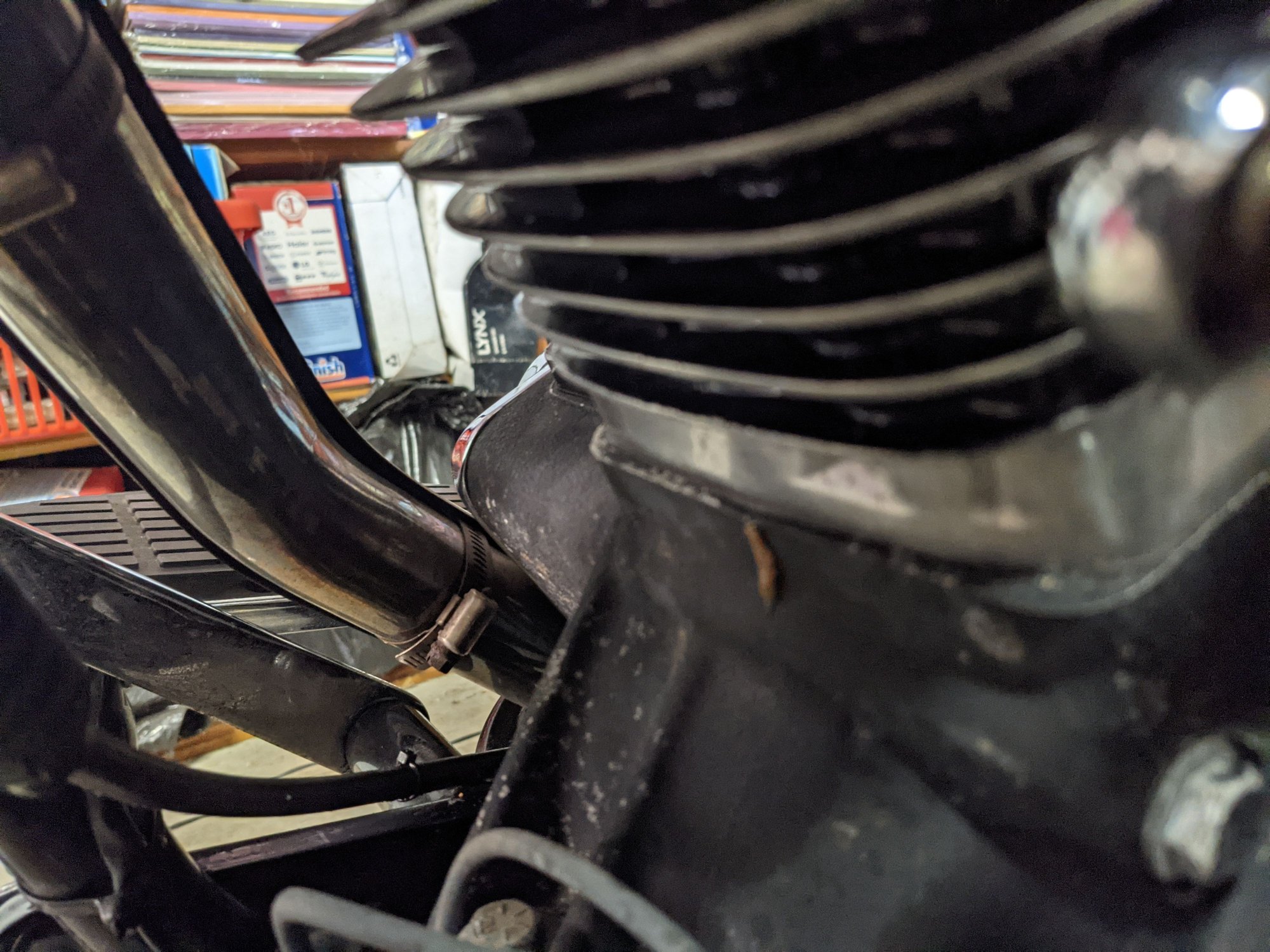

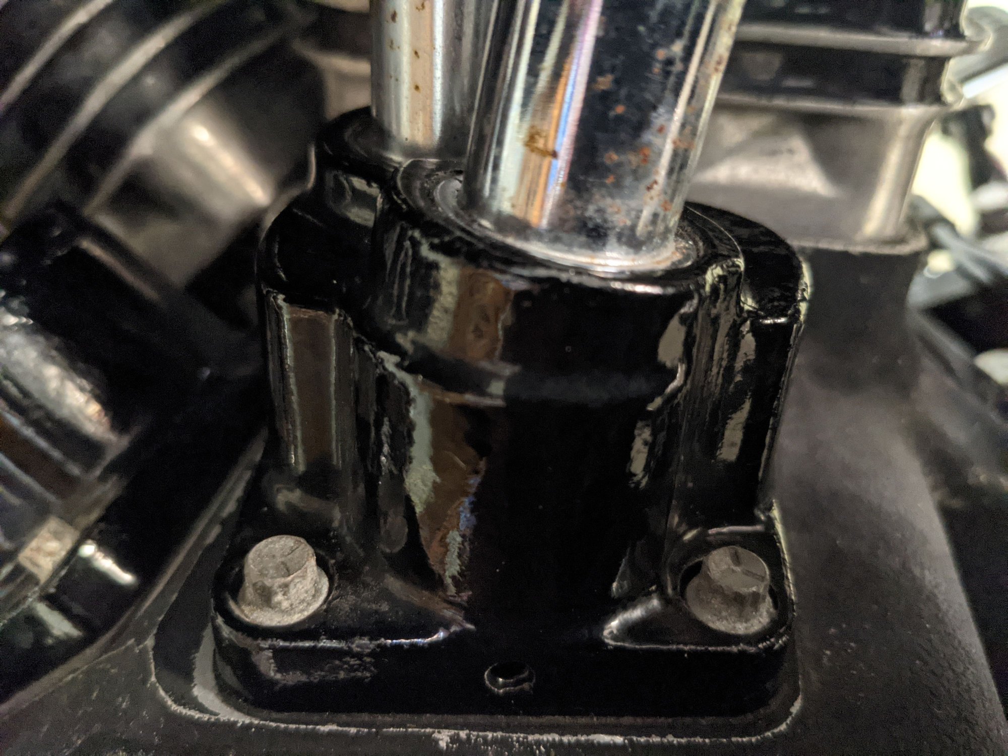

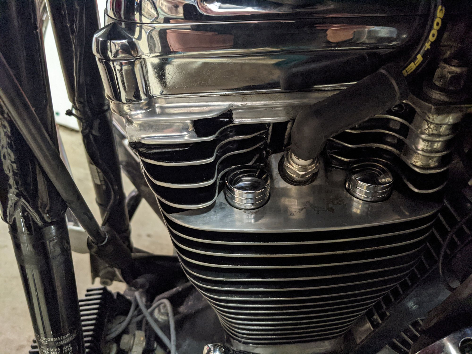

Now for my question...I am going to replace the lifters as the bike is at 27000miles, that's all I'm doing for now. When I got the bike home (I bought this off photos only) I noticed the heads have polished alloy around the plug region and around the base of the cylinders, plus the heads are jugs are gloss black.....do you think these could be after market? Or just cleaned up? P.O has no idea ....cheers.

The heads and cylinders might have been wrinkle black, or unpainted depending on the model bike (FLHS would have been unpainted engine and transmission, polished aluminum rocker boxes, primary cover, timing cover).
Lifters are a good idea, the first generation evo lifters had a reputation of failed needle bearings in the rollers.
Also keep in mind the 5 speed bikes before mid `94 had the old configuration transmission sprocket and associated hardware, they were known to come loose.

Yeah she's a FLHTCU so the heads and just were wrinkle black, so the gloss black and polished airea's have me baffled.
I know about the clutch and gearbox shaft, might update that when i do cam etc next year or when it needs it.

I would guess that there has been some polishing work done on the top of the heads and the base of the cylinders. I worked at a chrome and polishing shop years ago and it looks to me like something has been done there. Heads and cylinders removed, hard to tell from the pics. Or maybe the guy had some very compact equipment to reach in there.

Truth be told, with the after market paint and polishing on the cylinders and lifter housings, would dare to guess that there was a base gasket leak, and the parts pimped when they where off to replace all the gaskets that come with a top end kit.
So on that note, and the fact that the lifter housings where removed and painted as well, would get the old lifters out to see if they are still the original factory installed units, or if they were replaced at the time of the base gasket replacements isntead.
Also, would be a good time to see if there is an after market cam in play or not if you do pull the lifter housings, since if there is, not a bad idea to replace the cam bearing it it's still the original bearing with original factory lifters still in play.
Note, pull the lifter tubes up to begin with, to make sure that someone did not replace the OEM push rods with adjustable rods during the base gasket replacements, meaning that your not going to have to pull the rocker assemblies out to pull the rods. As for nose cone, up to you if you want to pull it or not, but if you do pull just the lifter housings and see a shim on the back side of the cam telling you its an aftermarket cam with shim, would be a good idea to replace the cam bearing at the same time as the lifters in cause all are the original factory installed units. Just remember to scribe line your cam postion sensor plate before you pull it, so you don't have to screw around with re-timing it after the fact.
