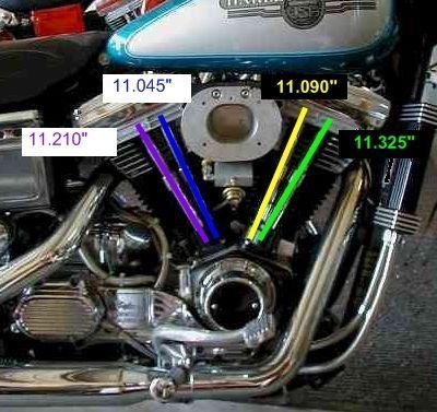

I doubt you have the pushrods mixed up because the exhaust pushrod is .235" longer than the intake which would have led to catastrophic failure.. As said might just take time to pump up...But just incase here's the color code for the pushrods.. Wouldn't take but a few minutes to open the pushrod covers to confirm...
