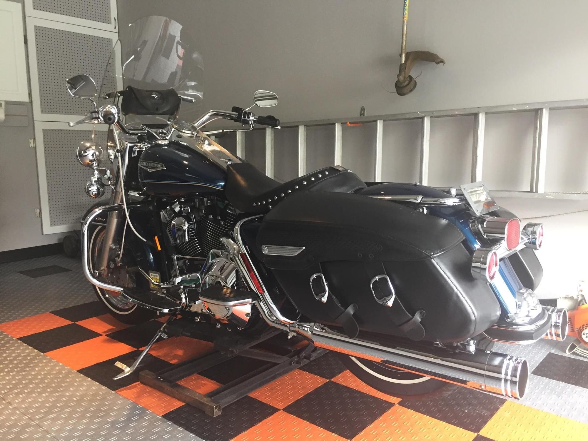

Thanks for that info. I have seen the video you posted and have done the TPS adjustment (.275VDC) changed out the whole linkage and small bearing on the cable side of the throttle body, added a new front head temp sensor, ISC actuator and adjusted both cold and fast idles to their respective rpm's. My issue is, after starting, the motor wants to fast idle (ISC has extended) but it starts about 850 and slowly creeps up to 1200 then after the temp has risen sufficiently, it backs off to 950-1050 which is correct. That's why I believe there is some correlation between the bleed screws and the small holes on the throttle body. When I get back north I'll dig out the epoxy on the bleed screws, determine what position (turns in or out) they are in, remove them and try cleaning through the bleed screw openings and see if it runs thru the small holes in the bores.
I have upped my bike to Stage 1 with the air cleaner, added true duals and Rush Big Louie mufflers. Currently I'm getting close to 50MPG and most tankful's in the 47 - 49 MPG range with average riding.
1998 RK Classic - 52K miles - original owner, purchased new in January of 1998
