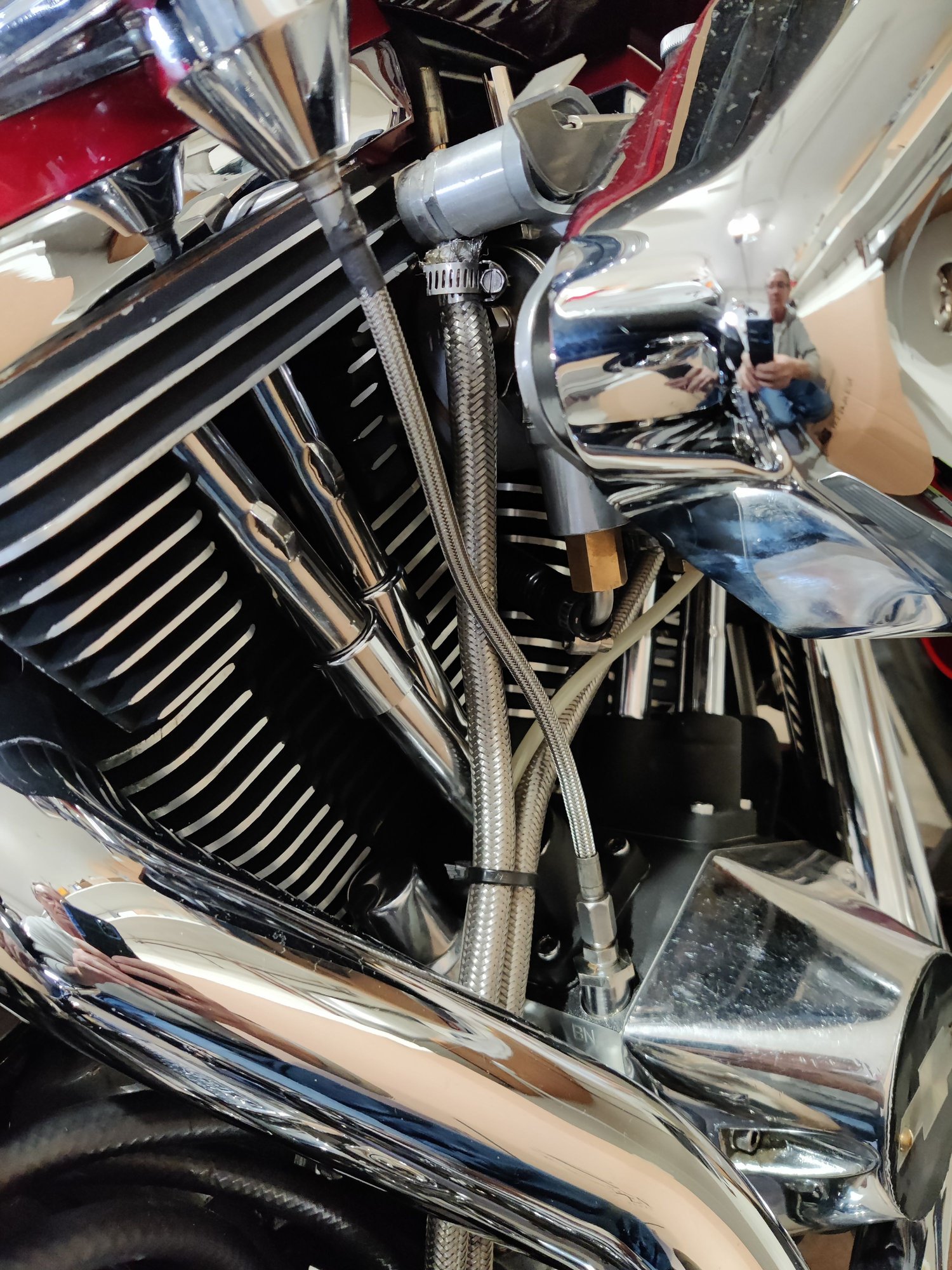

S&sS breather kit for an Evo... It doesn't get any easier than this. And if you want really nice looking stainless braided hoses coming off of each individually the way I did it in my picture those are actually 3/8 braided lines for the toilet fill valves plumbing parts...

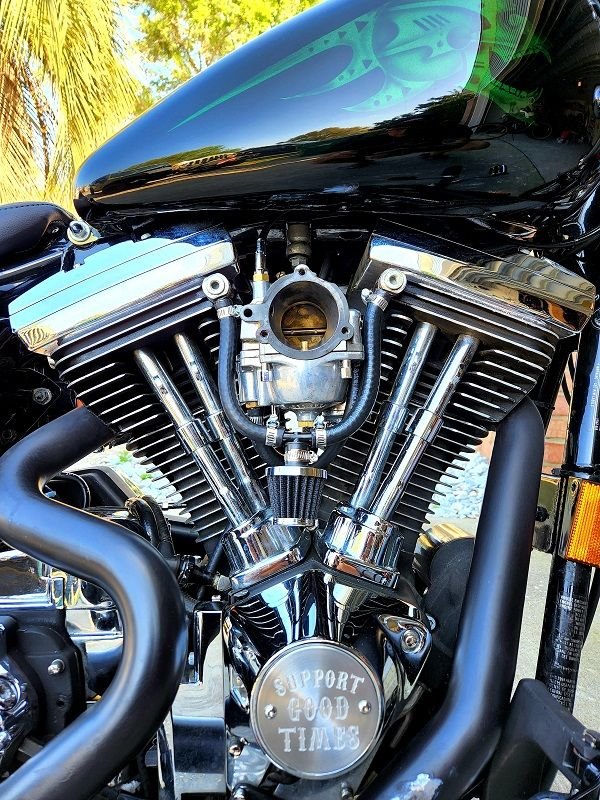

Well thanks for the guidance. Seemed pretty easy once I realized those two breather vents can rotate. Here's what I came up with with a run to the auto parts store. Probably a waist of thread but oh well

Looks good.....

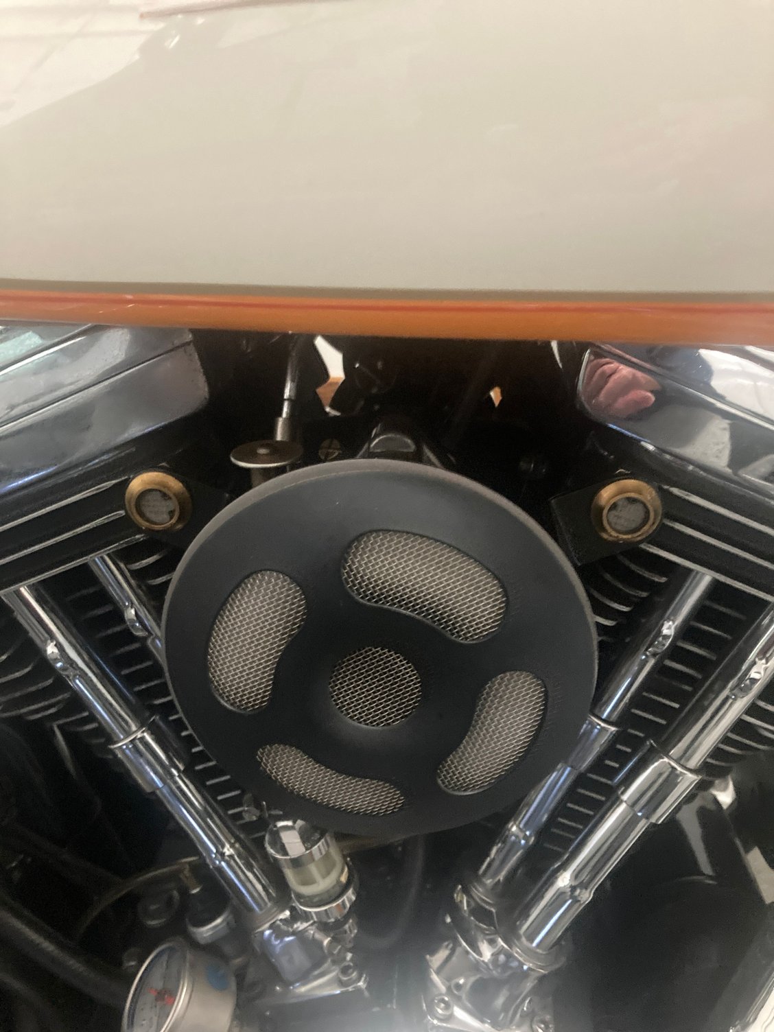

I use these breather bolts from Low Brow Customs.
Clean and simple.
I like the fact there are no hoses needed and the screens are washable.

I like those. I ran those on my sporty 1275 conversion and the only downside was the oil spray over the oil cover on longer trips. Looks awesome though!
