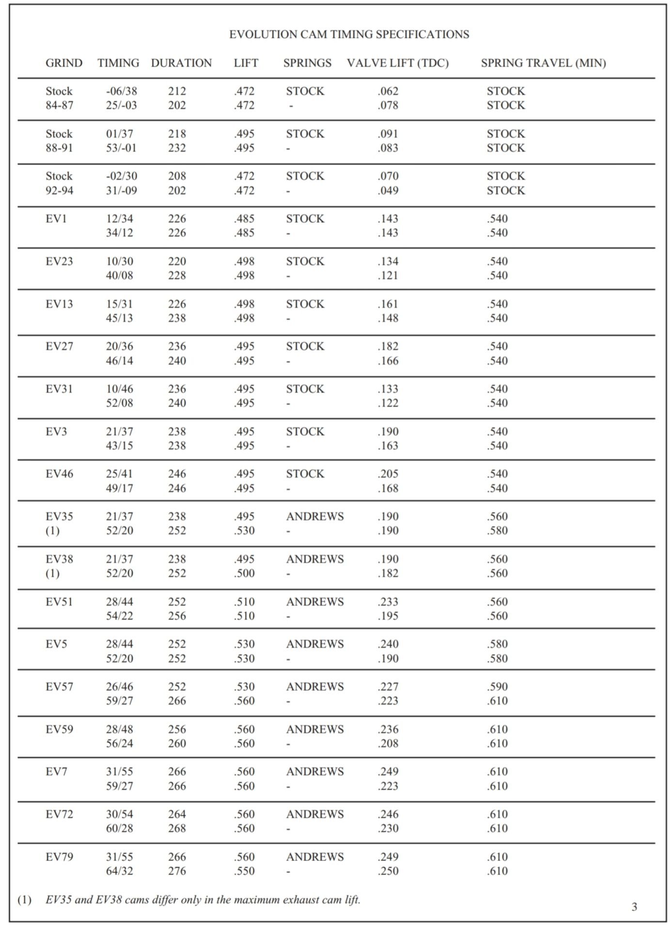

I haven't heard much about the EV23. How does it compare?
Old May 27, 2022 | 06:07 PM
brakeless's Avatar
brakeless
Joined: May 2017
Posts: 5,915
Likes: 5,928
From: NorCal
Maybe this will help.
