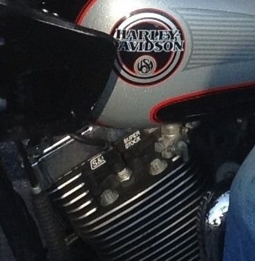

I’ll echo what Dan said above and suggest you replace those compliance fittings. If previous owner put a zip tie on the elbow rather than replace it he may not have been aware of a compliance fitting issue. With my 88 flst I bought it new so when a new noise showed up I noticed it and took care of it. When they crack you might notice a whistle sound… can check by spraying A SMALL AMOUNT of carb cleaner on them while it’s running, if idle changes it’s leaking.
I eventually put a S&S with S&S intake but I have replaced the stock fittings, it’s a bit fiddly but not real hard.
