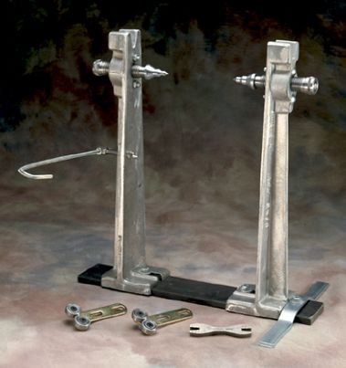

Me? Been owning a Rowe Wheel Stand for years... and some decent "spoons" as well as an old model "T" bead breaker... I do Everything the Hard Way.
I do Not work Flat Rate, nor ever for anyone else (not anymore)... so... All on Me.
Static Balance.
Static Balance.
I have the same stand. Been static balancing tires for years.
