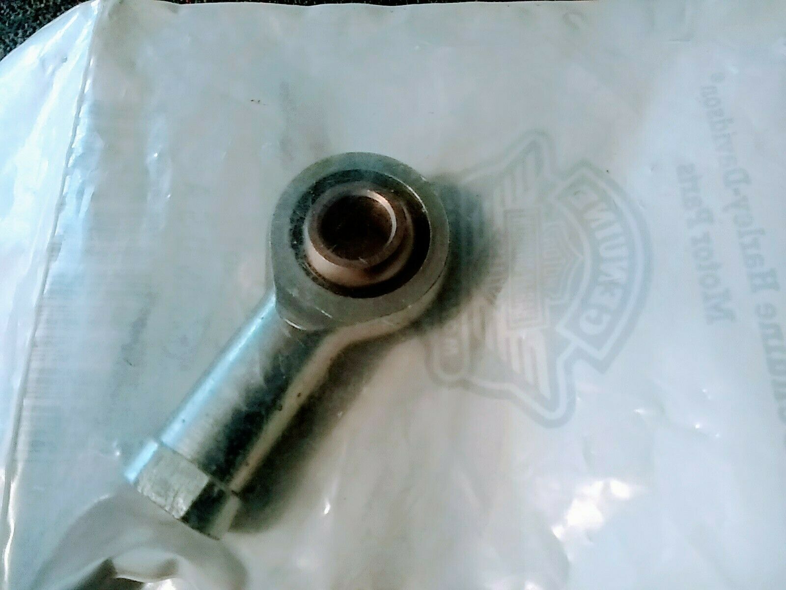

It is quite common for the stock shifter linkage connectors to go bad.
Your best bet is to replace the stock ends of your shifter linkage with heim joints.

A little side-to-side play on the shift rod end is ok, correct?

If you allow a little bit of slop in the linkage joints they will eventually add up and create a LOT of play/slop at the foot lever. From that point they will get weak quickly. I learned this lesson on my shovel.
If you look, you'll see the center spherical portion is wider than the outer part. So you can use a different length bolt, washers, whatever it takes and tighten the center portion firmly against the bolt head / lever and there will not be any "side to side" play.
