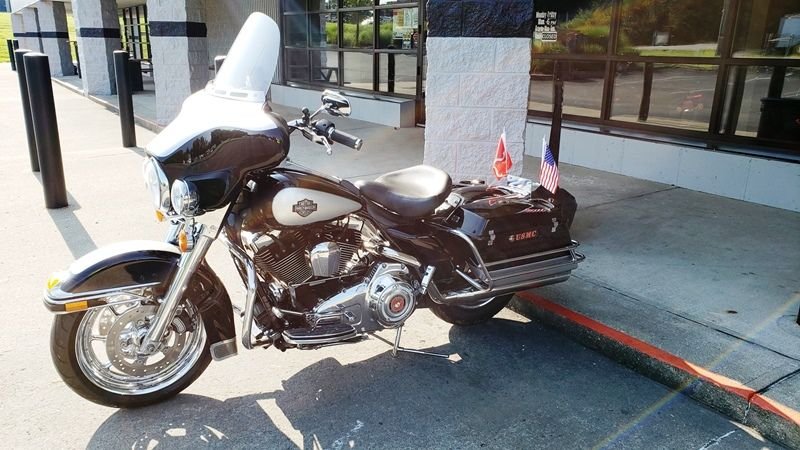

I use the Center Stand Part Number:CS-01 on my 2007 FLHTPI. I also raise and lower from my seat. As you can see, I have a police seat which rides higher than most. I seem to have no problem raising and riding off from my seat. My new left knee didn't seem to offer much difficulty. The Heritage Softail was harder then the Electra Glide.
A quick check on their website shows nothing available for your model/year.
2007 FLHTPI on EZ-UP CENTER STAND
