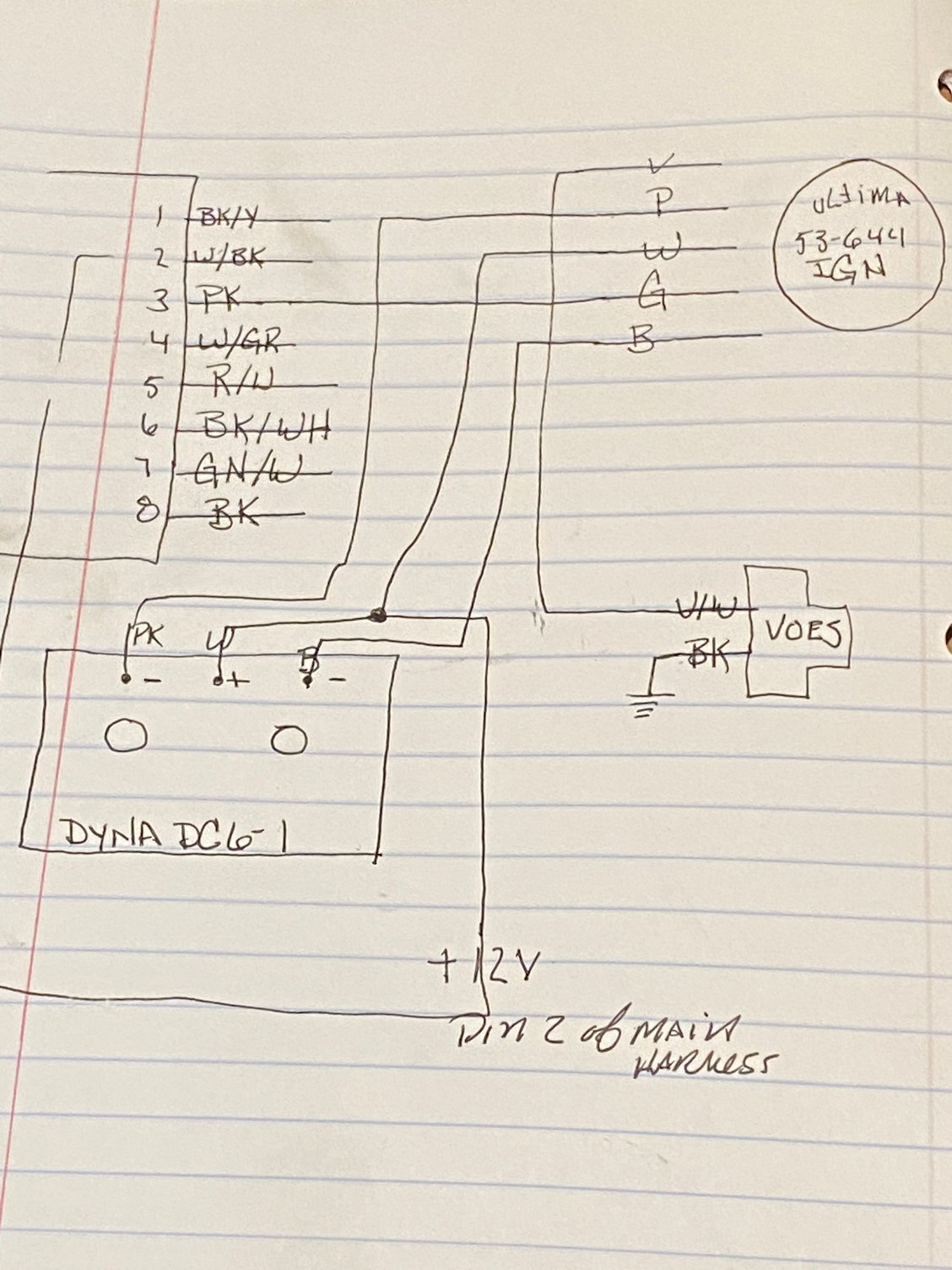

Here is how I wired my '98 FLHTCUI when I converted it. I used an Ultima Ignition

You can use the wiring attached to the module, looks to be the same as posted by flhchaz on the Ultima, The white wire mentioned in your manual for 12v power is a white wire with black tracer located under the right side of the fuel tank taped in the wire harness.

Ahhh ok. That makes sense - not sure why I was thinking it was impossible without a harness
