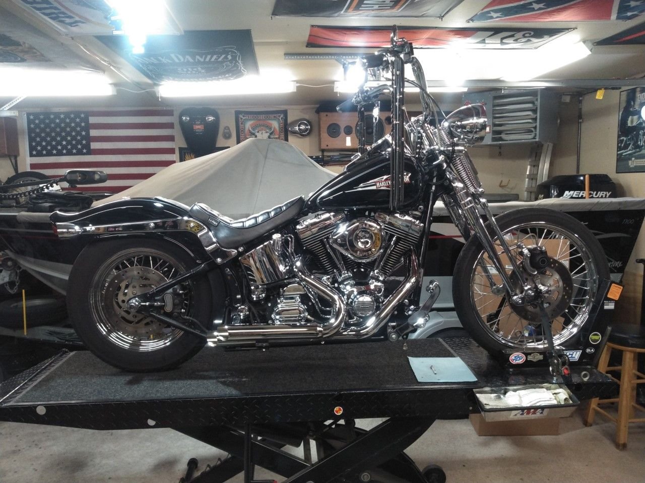

Having a really hard time finding three step drag pipes for my 90 Softail in chrome. Anyone know where I can find some? Preferably under $500..
If I can’t find any, anyone know a good place to have homemade ones chromed? My guy can’t do anything that large without a middle seam.
Years ago I started with the mathematical formula and tact the last section. I stretched it longer until mph went down, then I went back a half inch, next I stretched the 1 3/4 first section until 60ft times worsend went back the half inch and called it good. I compared that to just drag pipes tuned by mph and found the stepped really smoothed the mid range and increased 60 ft times.

Bassani pro streets. Pull the baffles.. You can also make your own..
IIRC RB racing makes a tapered drag pipe that works well.. Buddy had an 84 ci sportster that could turn into the high 9s (AHDRA) with a set of those pipes.

I just put these pro streets on my springer and really noticed a good increase in low end power and they are stepped wish i had installed them sooner!!

Update:
I now have the pythons with the hidden crossover (lollipops but have the baffles)
Bassani pro streets (have the baffles, might remove depending on tuning)
A set of 2” drag pipes and am searching for large volume side cut Cycle Shack Slip ons
After the 127 is broken in and drivetrain glitches are all ironed out I’ll do some track time and tuning with each set and see.
