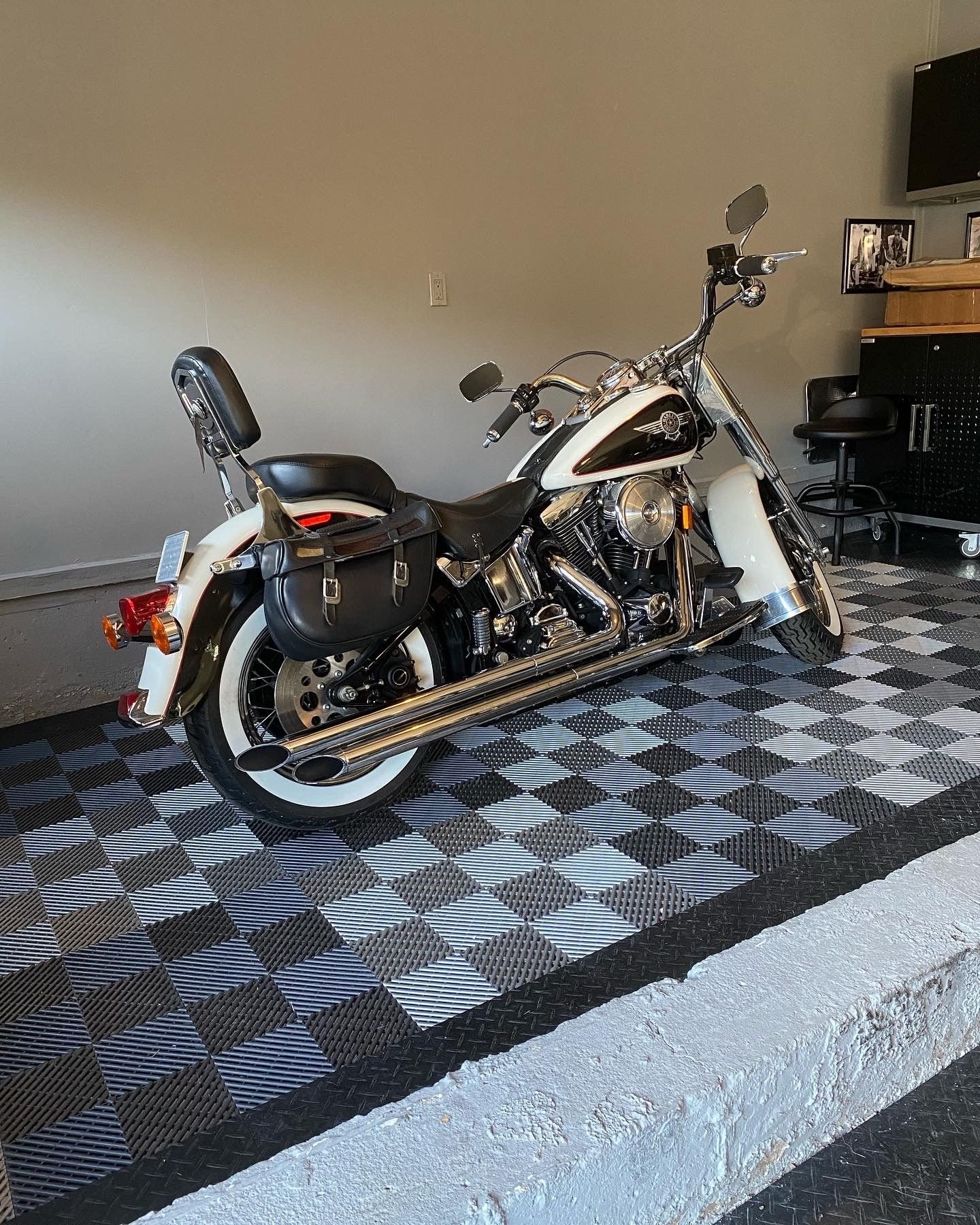

I actually bought the Cali air cleaner too from the seller. He took the parts of the bike within the first 6 months of owning it new, so they are mint. The carb is a 27035-92A for an early 93, which mine is.

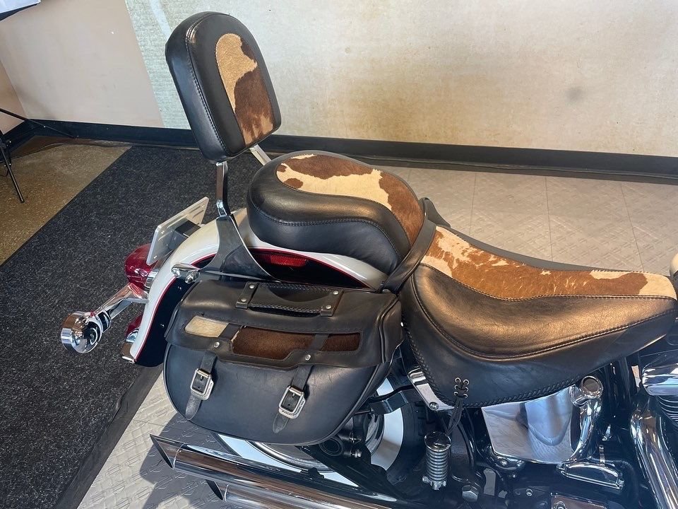

Original “Cow Glide” cool!
How’s the fur on the seat holding up?

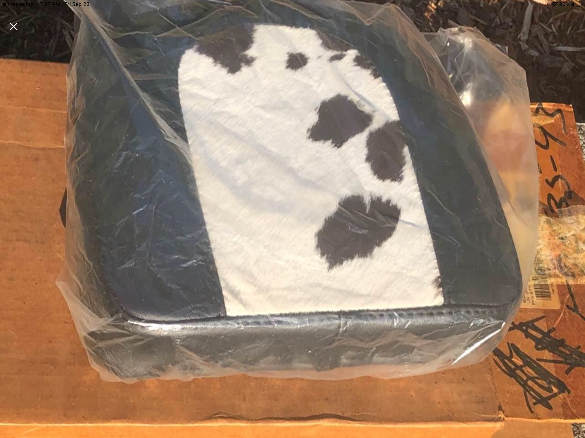

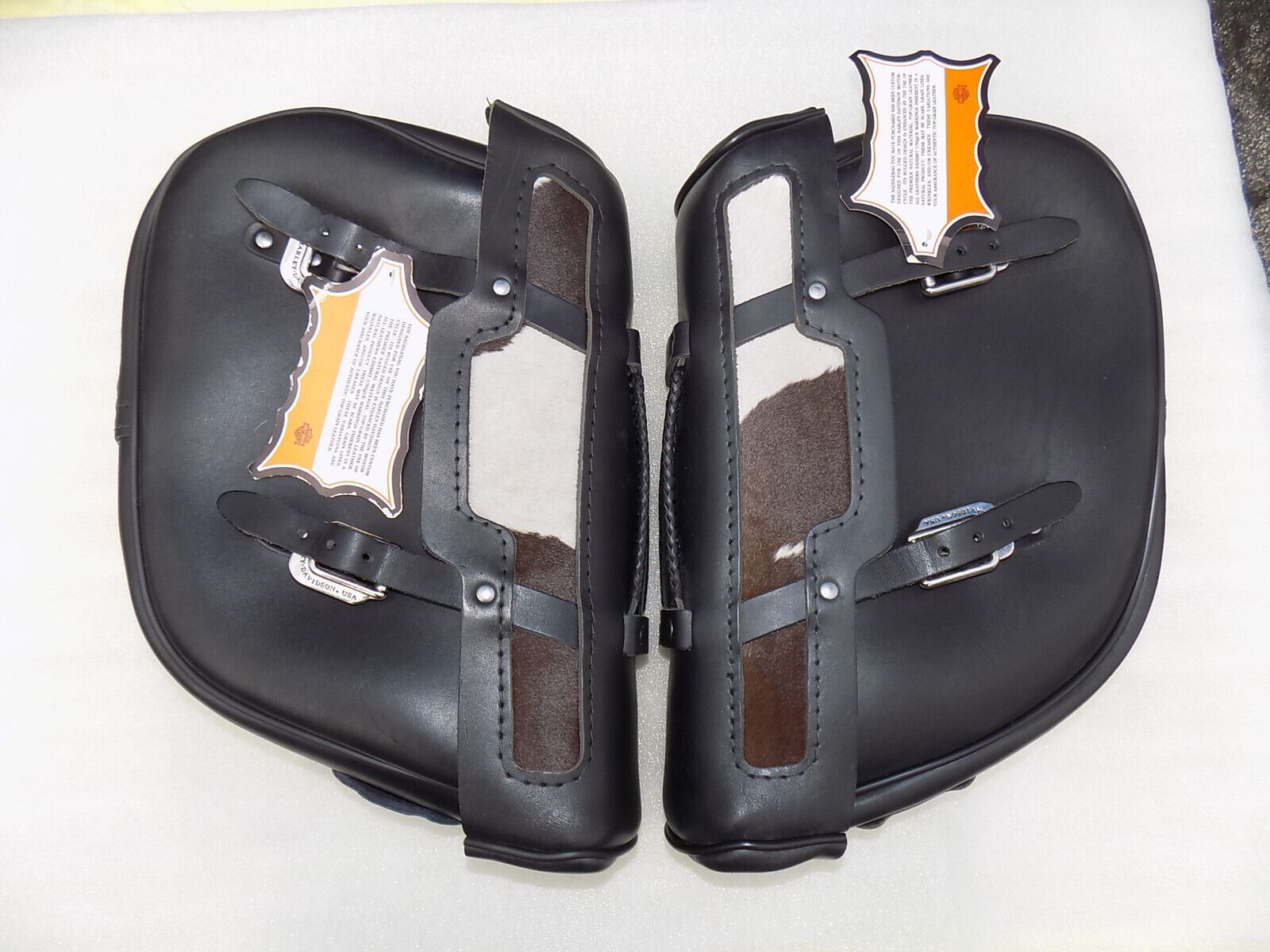

Thanks! The bike has 5,200 miles, so the seat is pretty good, but I’m looking for an NOS seat. I bought NOS bags and backrest for it so far…

So, you have 2- sets of bags/seats & backrest?

Yes, Sir!

I’d consider a different seat for riding… those seats are hard to find and pricey!
Good to know someone’s gonna preserve one for my great grandchildren to ogle.

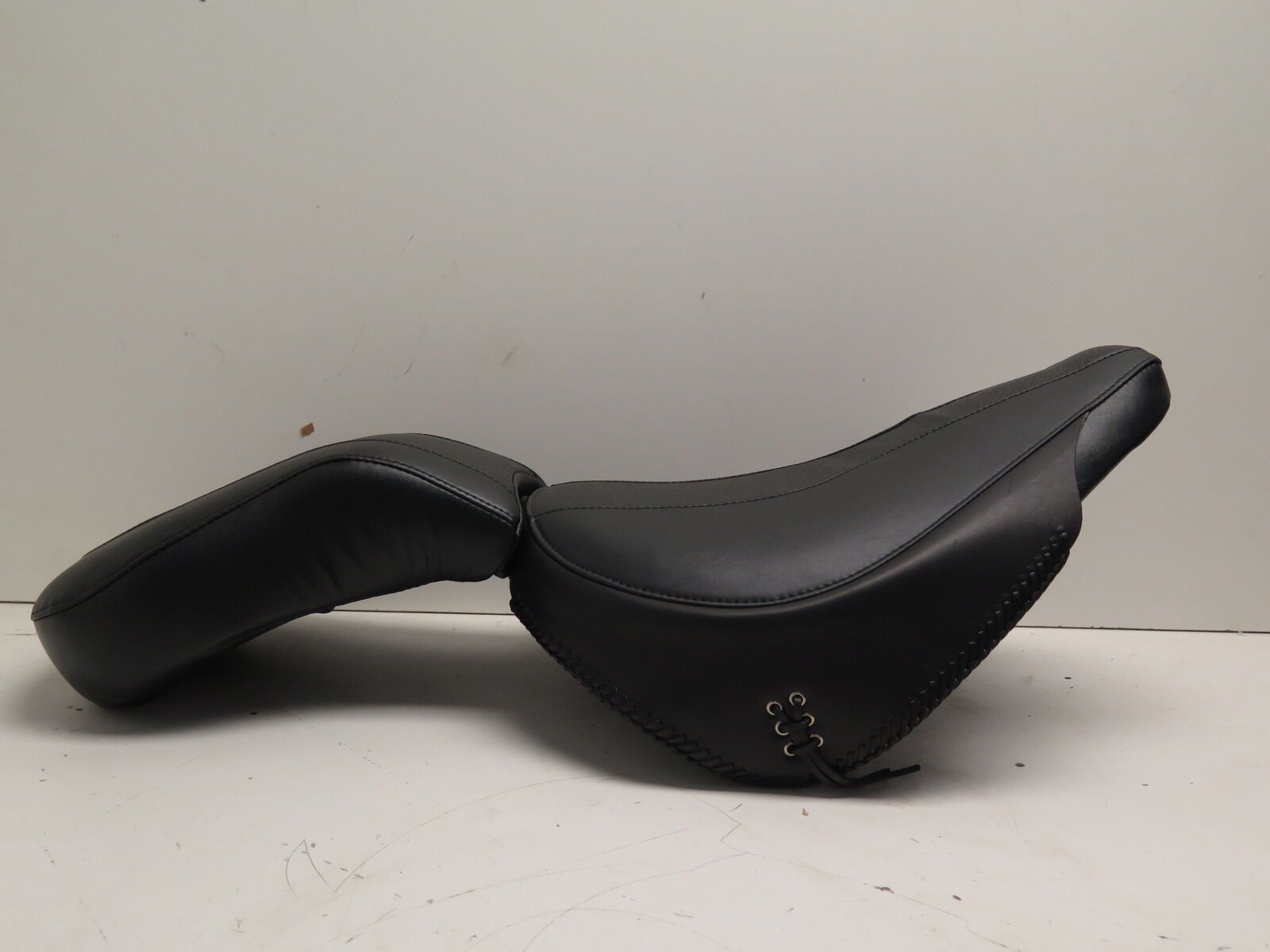

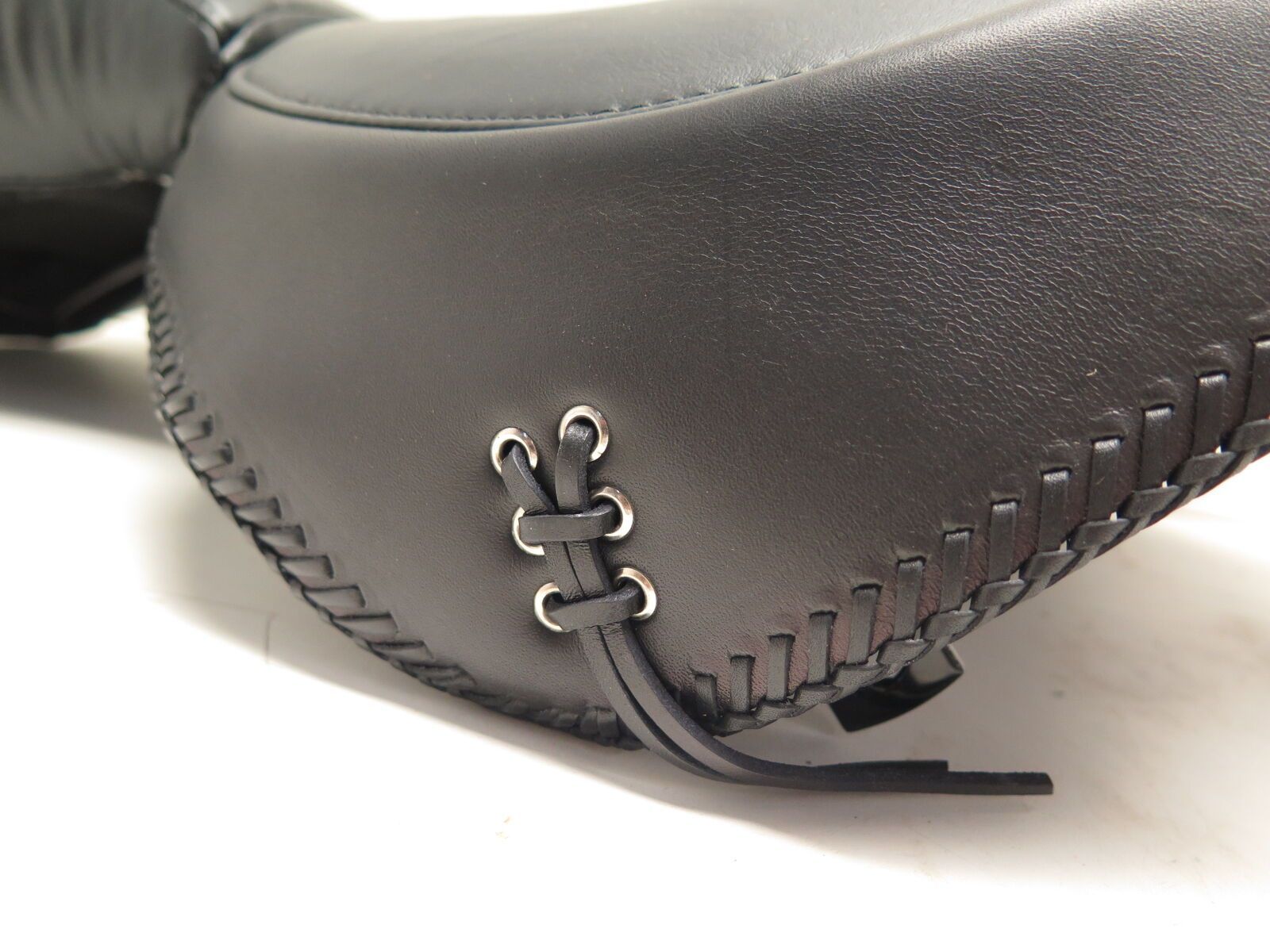

I’ve got 2 nos fat boy seats too, that I may use for riding. This isn’t my only bike and I’m 61 years old. I earned my hard *** award 30 years ago…
