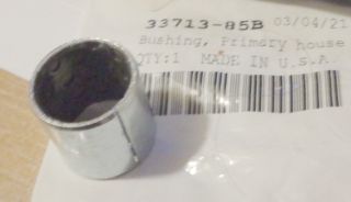

Yep it sux to be missing one piece. And not everyone lives where parts stores carry much small parts like they used to. Not every lives near enough to a dealer to make 2 trips to pay, order and wait for stuff either.
And I've never understood how a steel shaft could wear out against a nylon bushing, but they will. Saw a bunch of it with trailers/trucks with air brakes. Brake cam have 1/4" deep groove in the shaft and the bushing didn't need to be changed.
I was just now able to dig a spare out and didn't want to mistake the OD or length till I measured again. (In case you end up at a parts store) Shaft 5/8" x 3/4" bore x 3/4" long

Bet you can get that bush by the bag full from Mcmaster Carr or a local place like Grainger. Called DU bearings in the trades, use a lot of them on process machinery.
