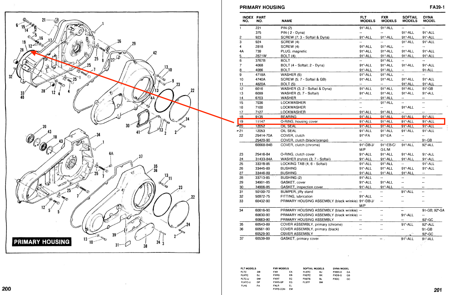

Sorry guys, I've been looking for the gasket/seal that seems to be leaking here on the inner primary and the only thing I can find is the "O" ring OEM 11147 as per the parts picture. Is it this? only the photo I took looks like its the lip of a flat gasket, certainly looks thicker than a simple O ring?
I just did a select on what you typed OEM 11147 and the popup Google search turned up many sources. Also checked eBay. Sometimes shipping is better there. Free shipping here , same outfit. Couple more dollars. https://www.ebay.com/itm/284145998000
https://www.denniskirk.com/genuine-j...prd/H26231.sku

Thanks so much for looking Jackie, I have one of the O rings in preparation for when i open up the Inner primary, my question was that in the photo it looks like a much "bigger" gasket rather than an O ring but I guess it is the O ring thats blown. Thanks again!

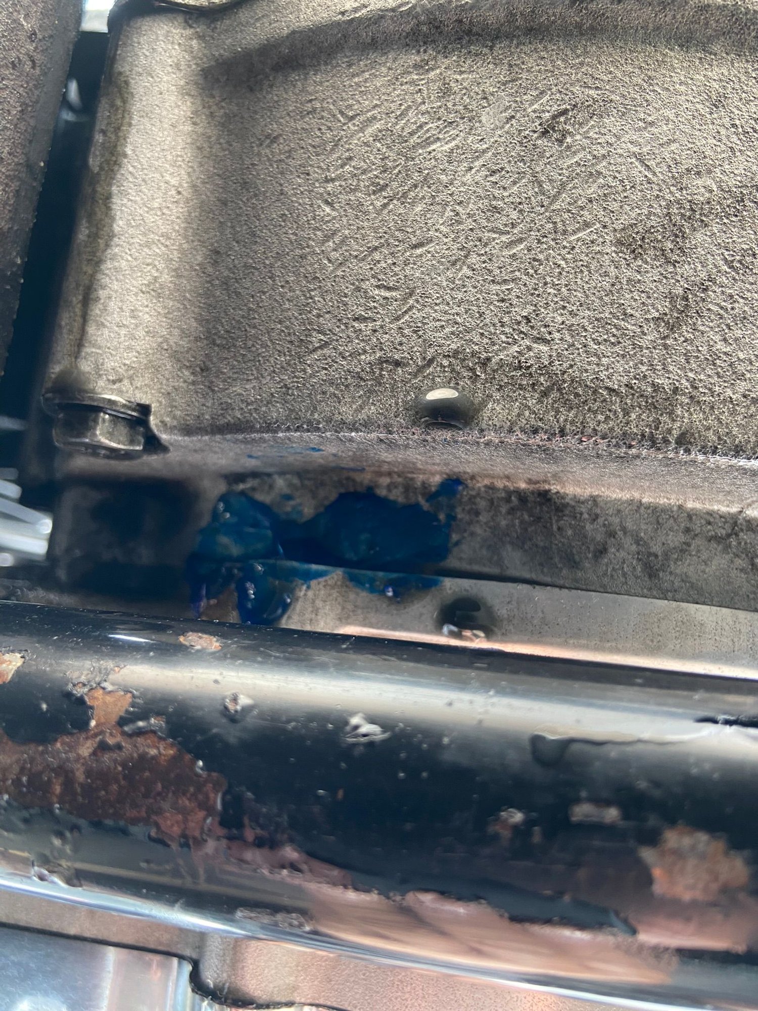

There is an aftermarket gasket that is available for crankcases that have a cracked or missing lip where the "O" ring goes. I believe your picture shows that gasket. You probably should plan on ordering one as they probably put it on your bike for a reason. I don't remember if it is used with the "O"ring or without the "O" ring. I put one on a bike that needed it once. It did the job.

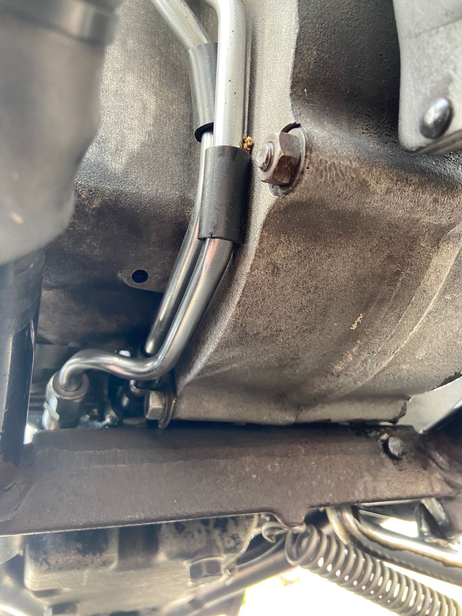

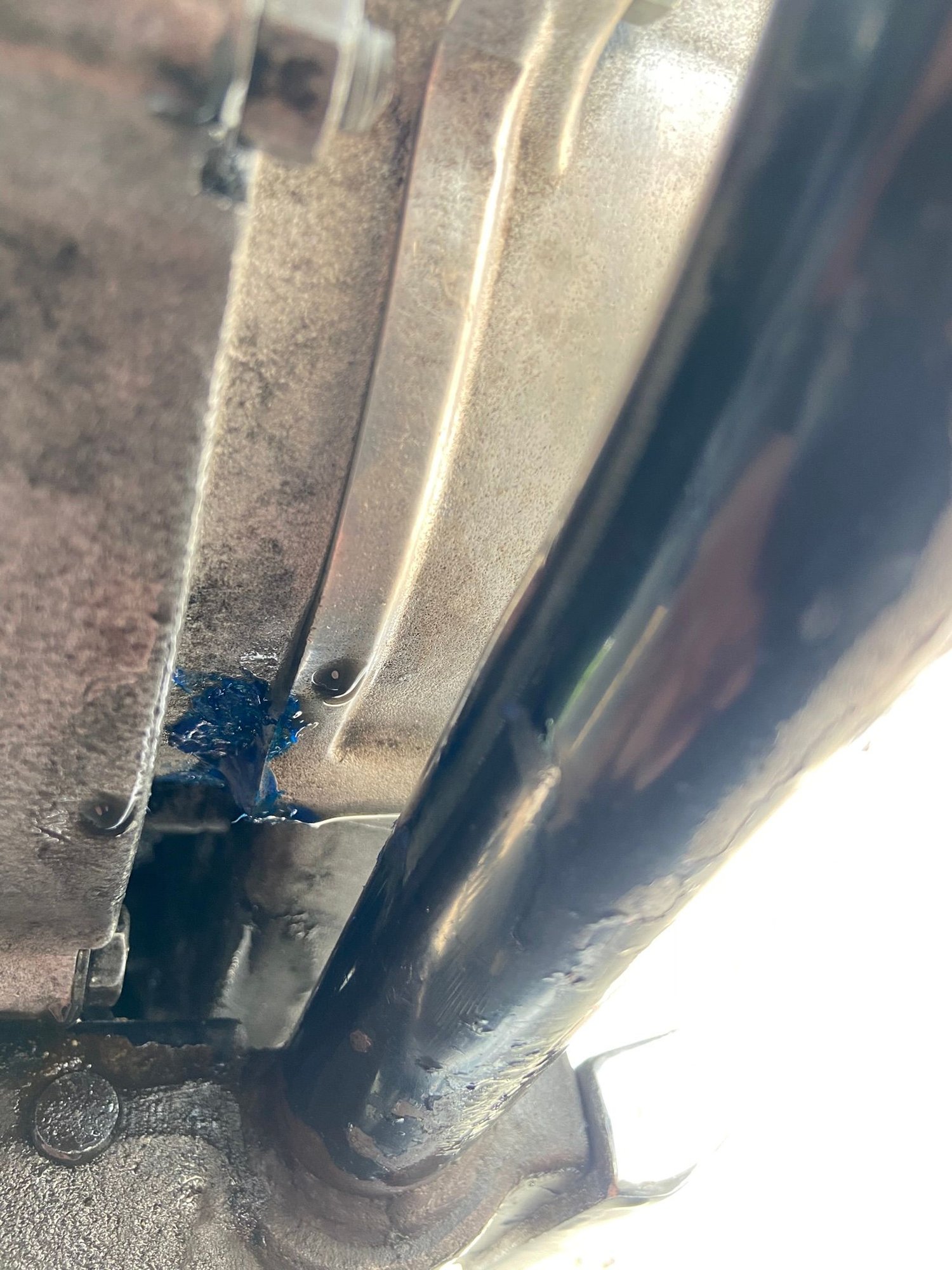

Thanks for that Mike, Ill see if i can find it.
For 6 years Ive been living with that leak and thinking it was the cases and what a mess that was going to be to fix etc.!!!! I put some Hylomar on it the are, not very well so will do again properly - to check if this was in fact the leak and IT IS THE LEAK!!! You guys have no idea how cool this is for me...it also validates all the other work ive been doing. simply epic!!! Hewres some photos oafter an hour heavy ride and a massive difference. Need a better patch but will do that later.
Thanks again!
