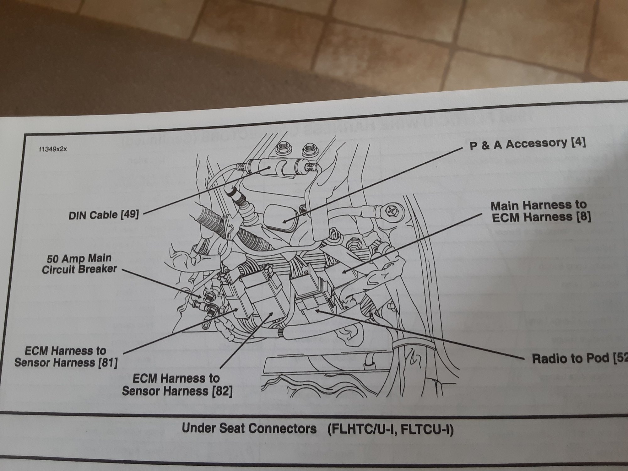

Here's the image from the manual. BTW I have one left for $30 + shipping

What page is that in the FSM? I cant seem to find it. But I think I see where it should be. Can it be reset? Or is it something that could go bad?

As for main breaker it between the voltage regulator and the battery, so when it has problems, you just loose charging to the battery.
