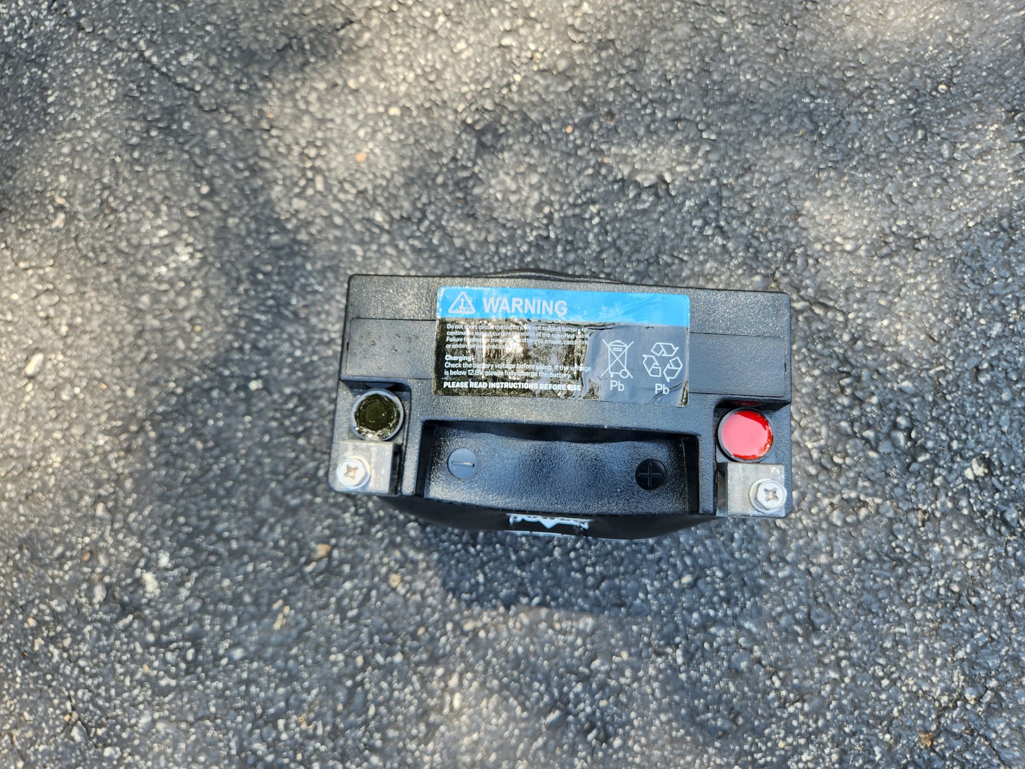

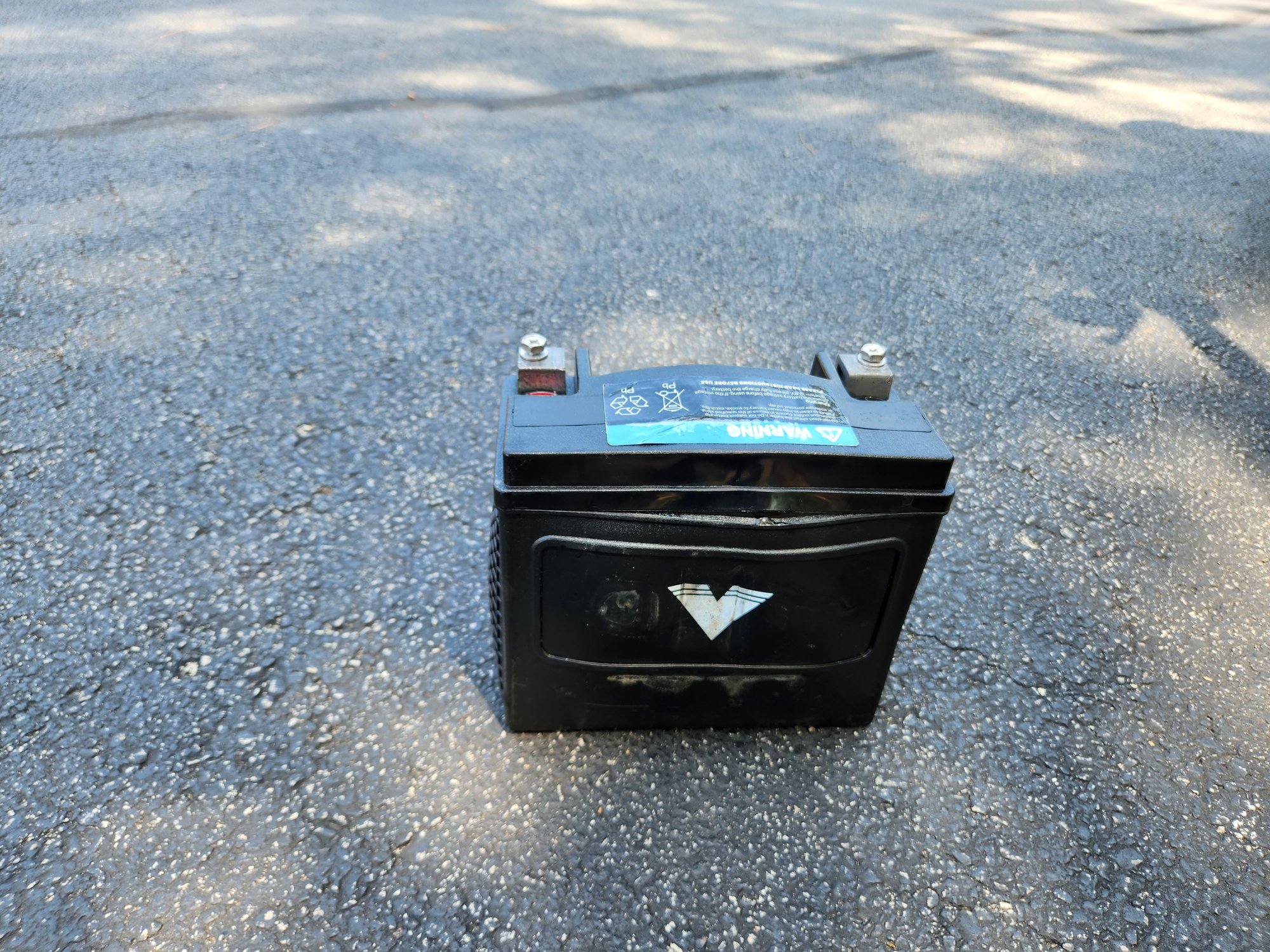

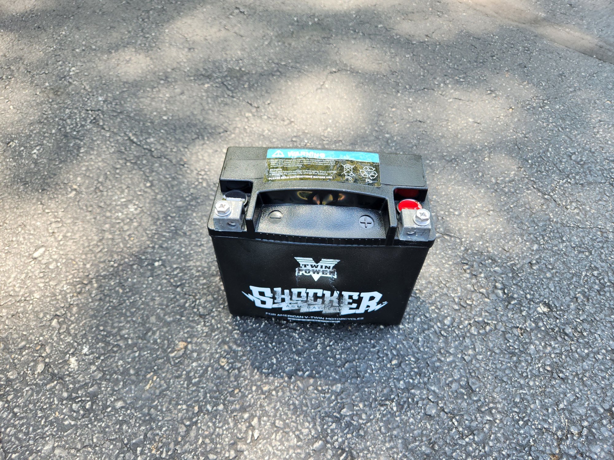

Took the bike out this weekend and logged some miles. On the way home stopped at a light and dead. No click, no start, nothing. Luckly I was next to a lot so pushed her in. Long story short, pulled the seat and heres the battery.
Did some troubleshooting and turns out my voltage regulator was pushing 18+ volts at 2000 rpm. New one should be here tomorrow.
