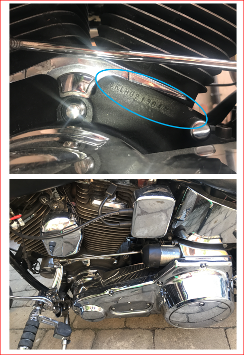

Hello,
I just brought home my first Harley. It’s a Softail Heritage Classic, 1998, EVO engine.
But, I think the engine was changed, is not from 1998, because it has bottom breather and also the solenoid starter. The number engraved on the engine crankcase is BKLH021904.
Can someone help, please, how can I find out details about the engine?
EDIT: the VIN no, of the bike, is 1HD1BJL47WY047716, and it shows no accidents.
Thank you
Marcel

Yeah somebody swapped out that motor.. It came out of a 1987 Softail custom..

How do you know is from '87? I mean, '84 - '88 were not all the same?
The bad thing is that I don't know how many miles this engine has ......

https://www.tabperformance.com/harle...uide-s/224.htm
BK = Model = FXSTC
L = Engine size = 1340
H = year = 1987

If it runs well and does not do worn out $hit like smoak and make noise seen 87 softail back in the day put 100,000 miles before rebuild

When you bought that bike did the seller tell you that it didn't have the original engine in it?

How did you register it without matching numbers?

The Same way I did my F150....The VIN is on the Frame...
Everything else don't mean ****...to the DMV
A number of my friends own titled, legal FX 's...yea... no E even... that are looking like Catalog FLH's... It is what it Is!!!
