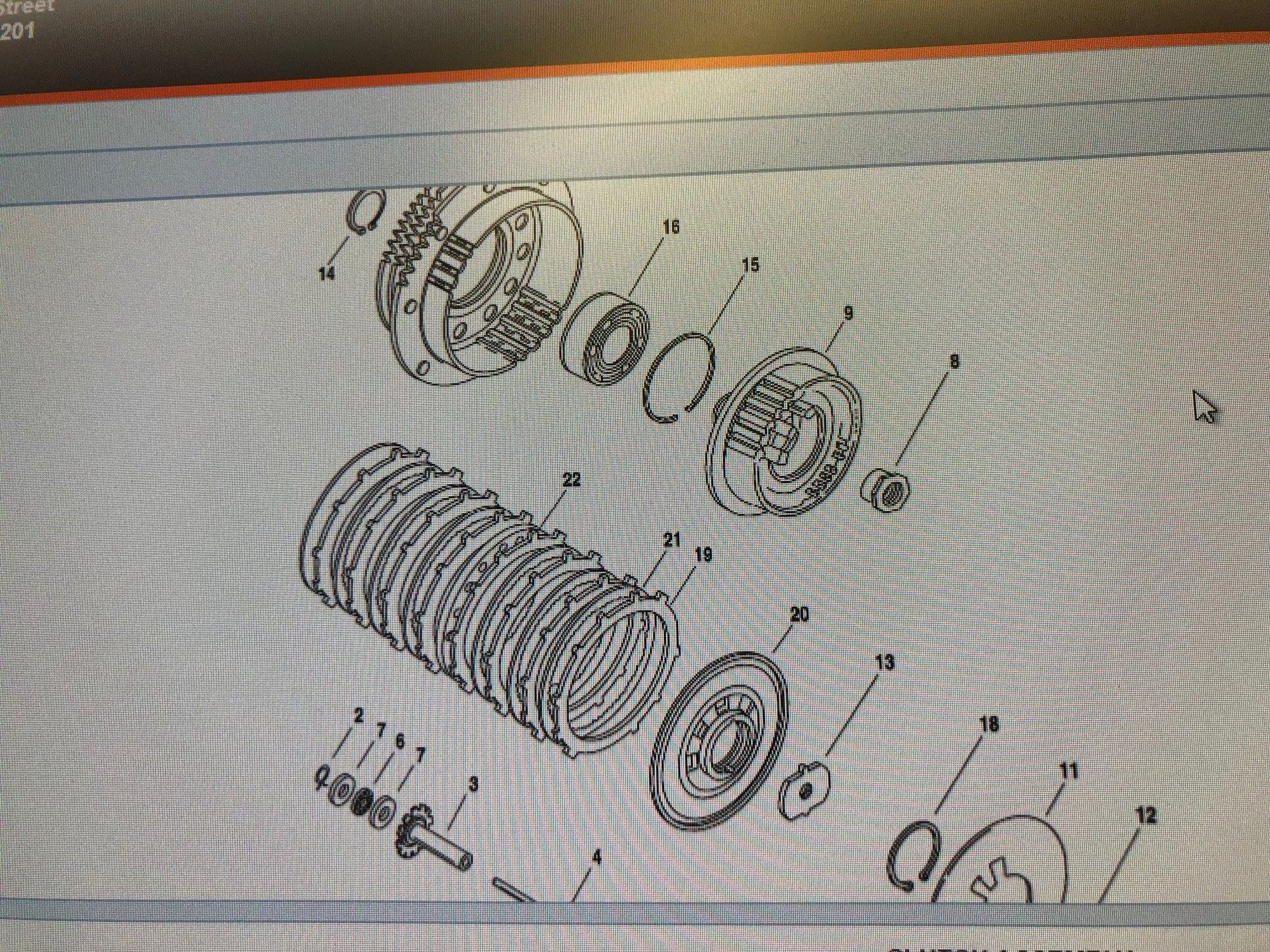

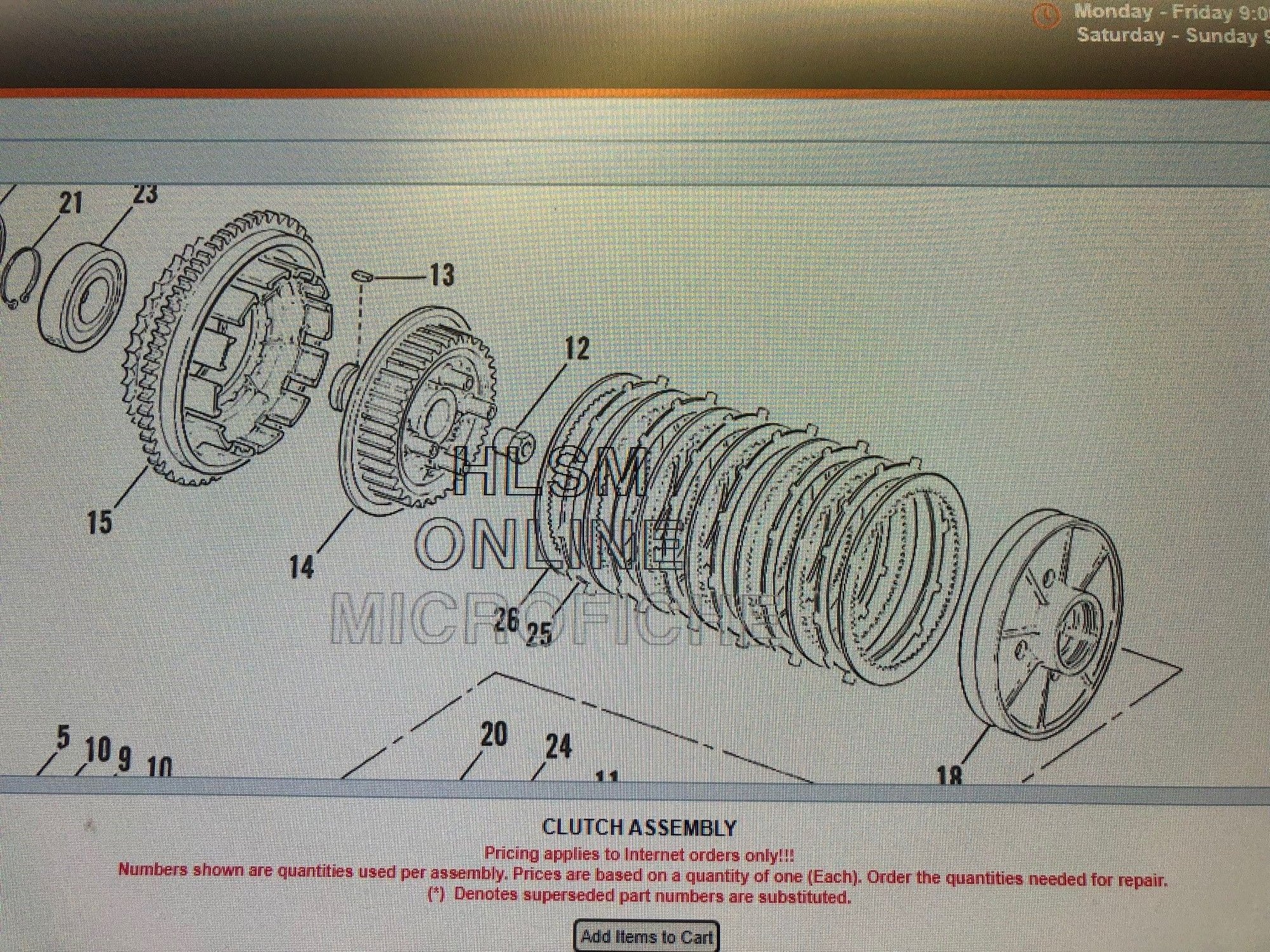

pic 1 is early style
pic 2 is the later version

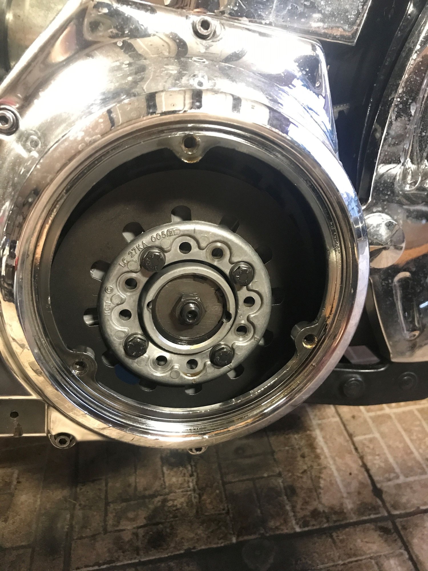

Thank you guys, just made the picture ... I think the clutch is the early one. Does this mean that the gear box has the tapered shaft? .... I would have preferred it to be the splined shaft ...

That is the early clutch, splined mainshaft.
Old Oct 3, 2023 | 05:36 AM
t150vej's Avatar
t150vej
Joined: Dec 2005
Posts: 5,442
Likes: 2,638
From: NC USA
It's the tapered mainshaft. Dan must'a woke up before coffee
