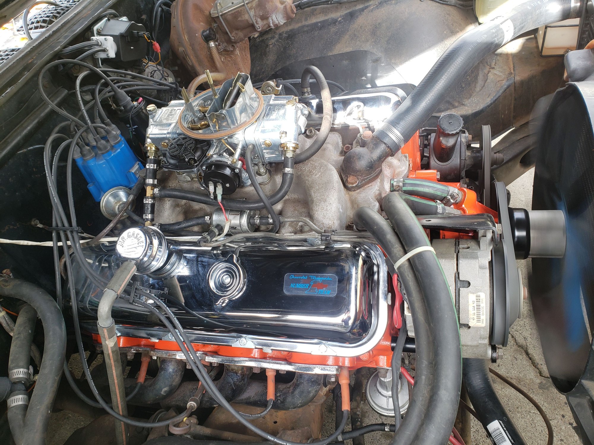

Those look like quality..
I used them on the fuel lines for the Big Block and they are as good as the factory Harley clamps.

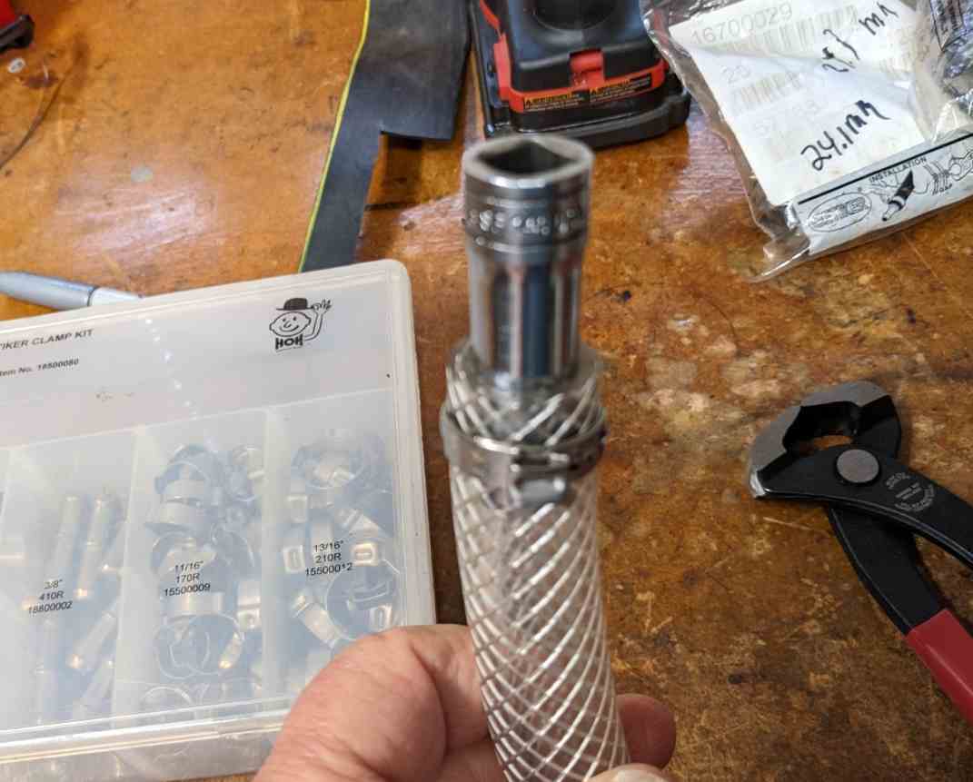

These compound cutters will split the nub if you grab it edgewise on the nub even with my old tired hands.. You can then pull it right off.
https://capritools.com/shop/klinge-c...-bolt-cutters/
Project Farm did a test of compound cutters and he like these. The work even better than the old Snap-On compound cutters I have.
Here is the process I use to remove the clamp.. Real easy, simply pull one of the nub halfs with pliers and it comes right off.
2 bucks down the drain
These are nice

Only about 40 cents for that one.. Install and removal are faster. Whats your time worth.. What's the chance the screw ones leak compared to the crimped ones.. The pan I'm working on will get crimp type connectors. It had those screw type clamps on the hoses..
Add;
For sure, do whatever you like.. Personally I like the crimp types as they appear much cleaner than the screw types.. Yeah, You blow 20 to 40 cents every time you remove one..
