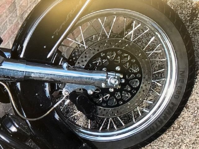

Originally Posted by Jhurt
The brakes. Definitely upgrade the brakes especially if you’re taking a passenger. The single piston calipers suck
I agree , and yes as mentioned the stock units will lock the wheel.
What they don`t offer is any"feel" for modulation for NOT locking the wheel
These Wilwoods were a vast improvement for me.
Fairly inexpensive @ Summit Racing
