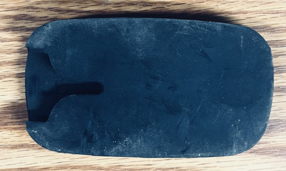

Problem on the 97's, is there is no adjustment in the master cylinder plunger assembly 38, to adjust the pedal up or down in the first place for its at rest position up, to start with,
As for pedal pad itself to pedal arm bracket, should be able to swap pedal pads itself, and if going to a narrow pedal pad, may need to shorten the length of the pedal bracket arm top surface (what the pedal pad bolt to), so bolting surface of are fits the pad. If pad you want to go to is the same weight as now, then should bolt right up without any mods needed.
As for the stock pad, will slip right off once you get the pad to release from the Vs in the lever plate top , and them can bolt up a more fancy pad to the lever that uses the bolting system, or just go to another slip on type instead.

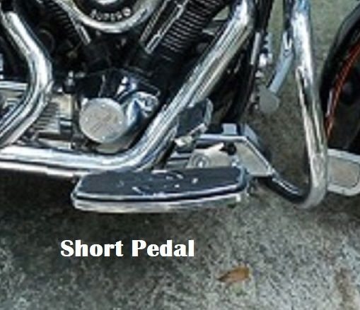

Many parts interchange up to 1999.
I swapped out the pedal on my 1993 FLSTC. Got it at a swap meet for $10.oo -

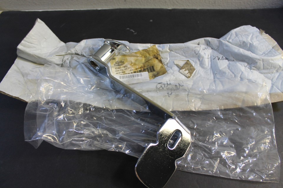

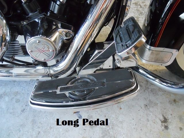

any idea what model bikes came with the long pedal, so i can search for used ones?
Thanks.
