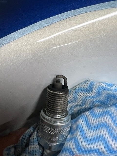

Photos of new plugs after approximately 30-40 Miles

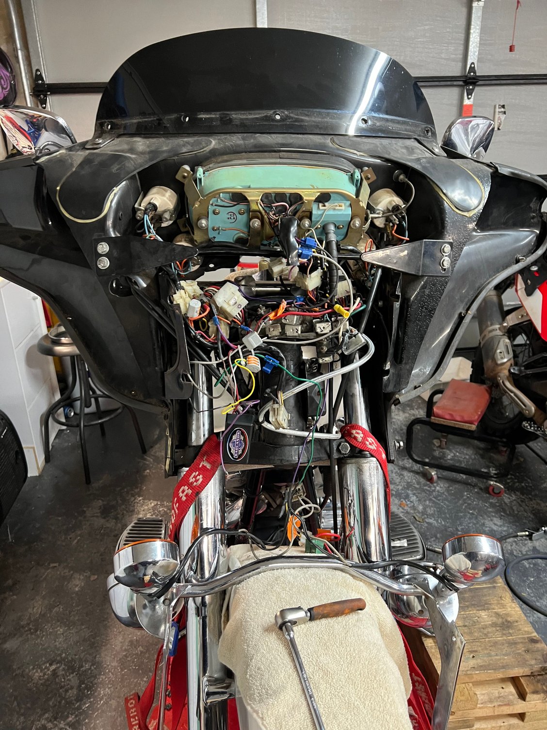

I don't want to make a 3 page explanation so just trust me - remove the outer fairing. There are 8 - 10 screws, seems the ones on the bottom are sneaky, hard to see. When that's off, the breakers are left to right; COM, IGN, LITE, ACC. I'm wagering the posts on the breakers are corroded and/or loose.
Many guys here replace the breakers but they may be hard to find there. My '87 had original breakers. When you're near done, leave the short, green jumper totally off. It insures the lights are on when the ignition is on. Leave it off To test the starter button or leave off permanently.
If you're not 100% confident that takes care if it, find the connector between the main harness and right handlebar harness. Check all the pins and sockets for dirty, burned or loose. While you're draining gas and checking petcock strainer, pull the tank and clean and tighten the ignition coil wires.
When you're done, have a few stubbies and kick back.
Photo shamelessly stolen from daven9113

circuit breakers all good
ignition wires could get a 1/4 turn out of them
Now ignition position works everytime
petcock had terrible flow in “on”
great flow in “Res”
pulled apart and now has flow and a great leak
new one to come
check coil and discovered loose nut on terminal
fixed
found lonely wire hanging in the breeze
checked schematic and is from VOES
Fixed
checked earths and hot the road
lets see what happens next ride
