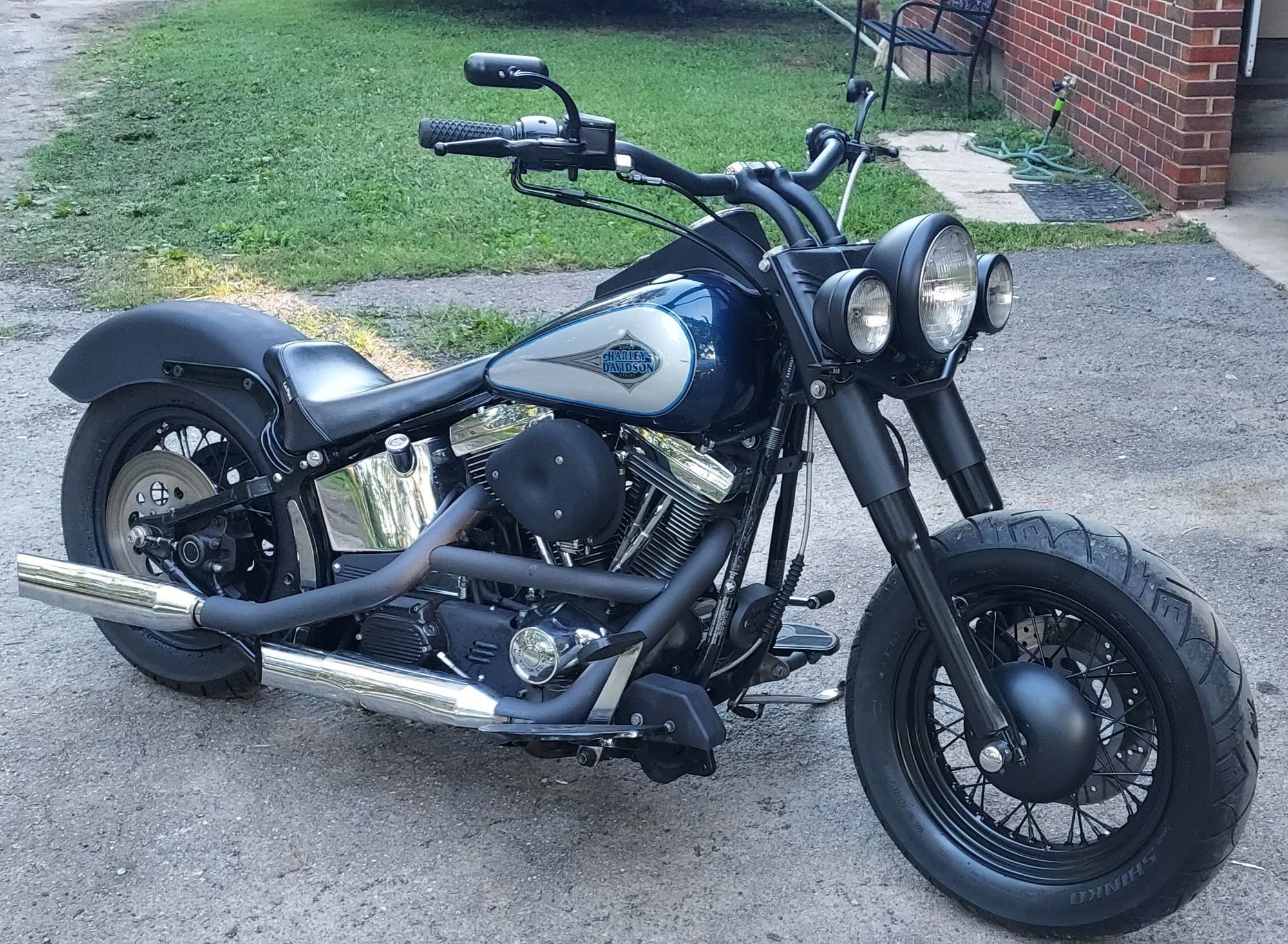

This is my first Harley, so please forgive me if this is an obvious fix!
I took my Softail out for it's first test run last night & noticed that I have to tap the shifter twice to downshift. I've removed the heel shifter & had to adjust the toe shifter downward, due to an ankle injury (I can't flex my foot upwards) Could this be a lever angle issue maybe?
I did change our my transmission fluid. Replaced it with 23oz of 85w/140 (as suggested on the forum) & up-shifting is very smooth, although neutral is tough to find at a standstill, but I understand that that's just one of those harley things.

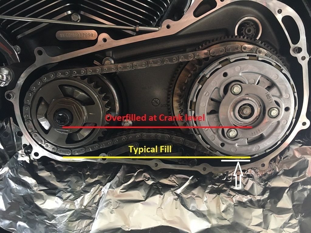

Along with the good above recommendations, make sure you do not have too much fluid in the primary.
