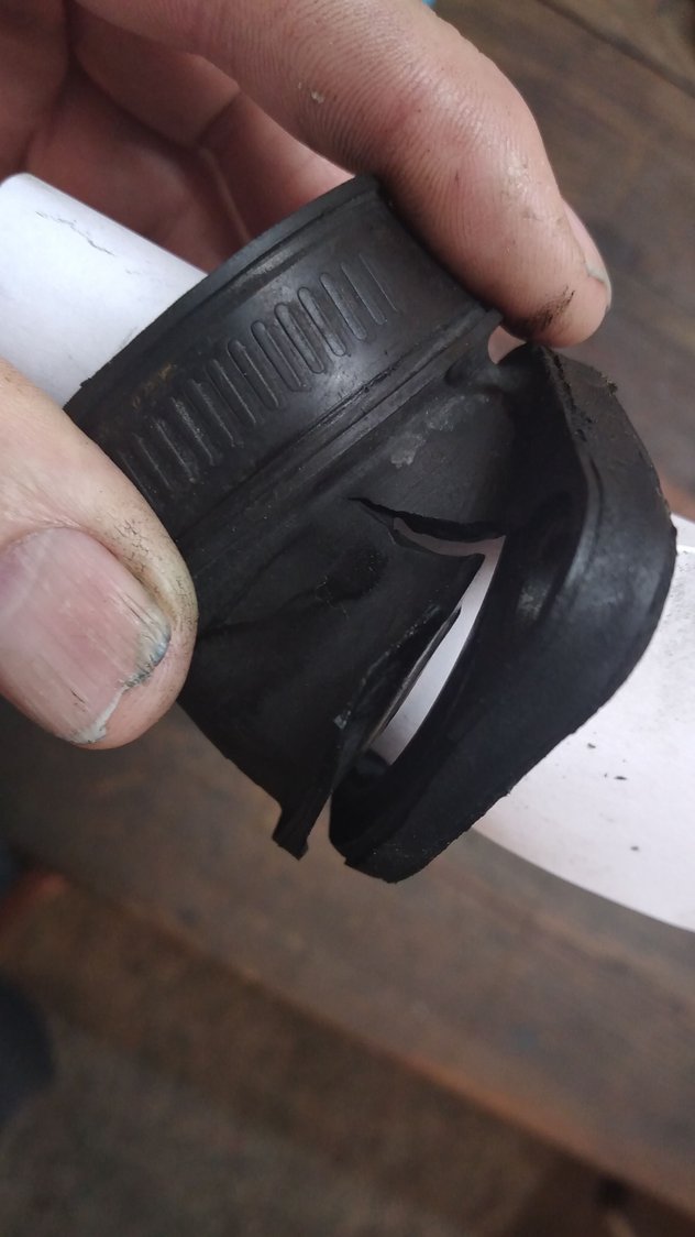

Here's what my compliance fittings looked like , my front cylinder was not firing right
My new to me evo Wide Glide would not run on both cylenders, replaced compliance fitting & all is well . . .
Good luck keep us posted.

I changed these gaskets/manifold seals. I assume it's not the same as compliance fittings?
