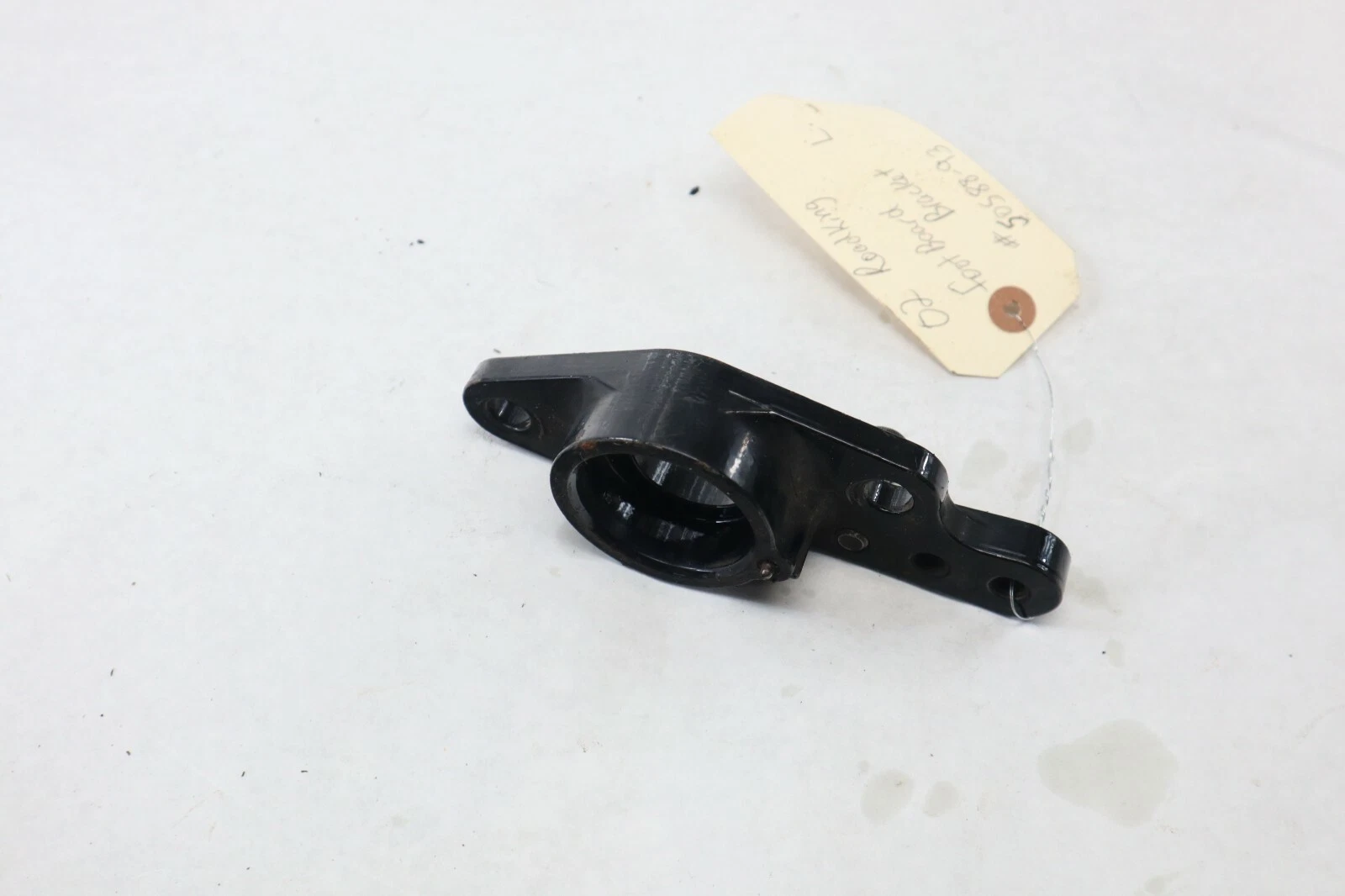

Originally Posted by t150vej
1997-1998 any Touring model including Road King, Road Glide, all FLH Part# 47549-97
I wouldn't weld that one if you intend to ride it. Good time to convert to bearings, you wouldn't believe the difference in handling unless you did it or rode one already converted. Regardless, use OEM only swing arm isolators 47564-86B
If searching ebay, Pinwall in Ohio is good source for used touring parts and very honest with description and photos. Good people to deal with.
Just a quick search, they're rather few and expensive. Good luck

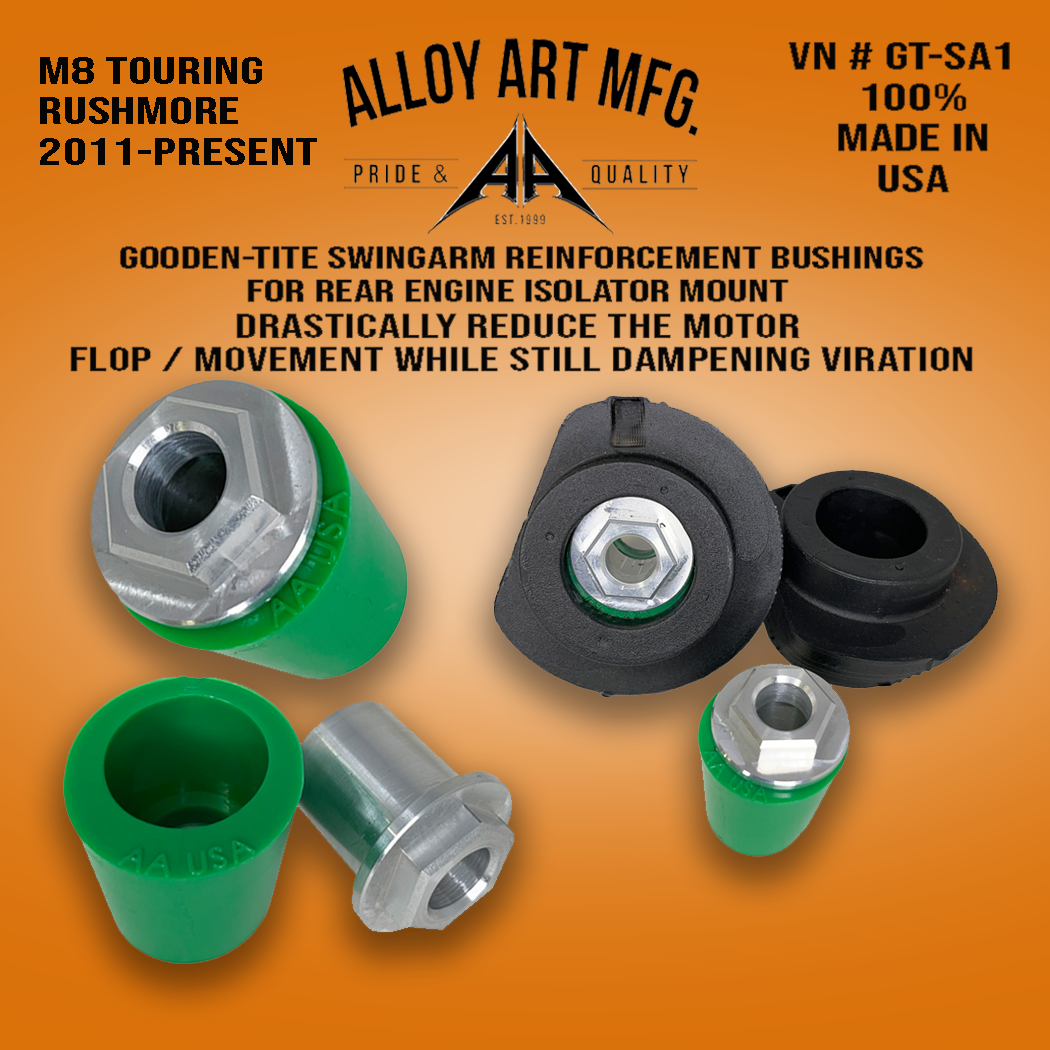

I have ordered the Alloy Art swing arm bushing kit,
That should support the isolator mounts.
In combination with the OEM mounts it should improve the stability.
I'm excited to mount them and about the result.

That bushing kit says it's for 2011-up?
Pays to shop and if you're not in the continental US, and sometimes if you are, getting genuine parts, especially for an Evo can be difficult.

Sorry, was the wrong link.
I ordered the right ones for my Evo.
I ordered them directly at Alloy Art.
I orderd the spherical bearing kit too.

Your going to have problems ,since the slot in the rubber is for the later/after market type side plates,
While your side plates only have the small roll pin for this type bushing to index correctly,
https://i.ebayimg.com/images/g/gRsAA...d/s-l1600.webp
So find someone that can lathe you up two buttons that you can press on the side plate roll pins, to get them to the correct width, so the slot type side bushing detents does fit to the side plate pis correctly/indexes the bushing to side plate correctly.

No worries, and the press on buttons can be round (don't need to be oblong), and just center drill them so they can be pressed onto the roll pins,and round in OD so they fill the rubber bumpers slots the full way sideways, so the rubber isolators are both indexed correctly to side plates both sides.
I bring this up,since when I do the spherical bearing upgrade on my swing arm, the kit came with the later slot type rubbers (instead of earler type pin channels), and had to do the same to use them as well.
As for drive line alignment tools, have a Gorges set that works very well.
https://www.georges-garage.com/produ...lignment-tool/
And since I went with the progressive stabilizer link, after my delrin inserts that I made on the lathe caused too much frame vibration.
Came up with right side tool washers mod, to that side alignment too worked with the progressive plate as well.
Note, maybe with our green inserts made of poly, will not the vibration transfer problem to the frame that I had with them made of delrin.
Hence sta-bo used to make then out of delrin as well, but switch over to poly as well to reduce the the amount of drive line vibration to the frame through them.
And just a note, but the kit only comes with the green poly inserts and silver insert spacers, not the rubber isolators.
https://www.alloyart.com/collections...ement-bushings
With luck, your stock axle shaft will be long enough to work with the spacers that are going to push the end nuts out father, than if just seated against inside face of rubber isolators if not installing the Custom Cycle Engineering Spherical Bearing and Pivot Shaft Update kit Part #1302-0208 that has the longer axle shaft as well.
