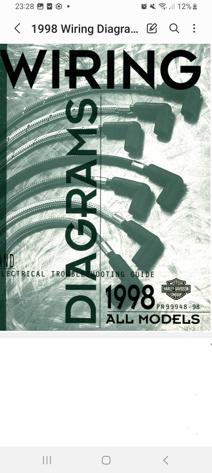

Should I send you the original manual for the electrical system as a PDF? Everyone swears by the ignition that they drive themselves, it's like oil, everyone knows better. I don't know if the Compufire is any good. I converted to Dyna S and am super satisfied.

That is very kind of you thanks - if it is in the clymer manual i wont need as I have one on order, I assume it might be in this.

I don't think there's as much in Clymer as in the original book. The original book for electrics already has 350 pages.

Hi yes please - given your thoughts on the Manual I am buying yours might come in useful - let me know if I owe you anything please- pm me if i need to give you any details and thanks once again.. 🙏

One more thing if you can get a Factory Service Manual do so.. The Clymer isn't bad but it's not as good as OEM..
I think I may have located an oem service manual but can’t confirm the part number -the one I have is 99482-99 - would you know if this is correct? Thanks
