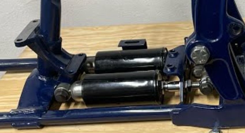

I'm still waiting for pics so my small brain can comprehend

Heres a pic from a Google search. Although those front bolts appear to have plenty of access, they are just below the frame rail, so you dont have a straight shot with a socket and extension.
