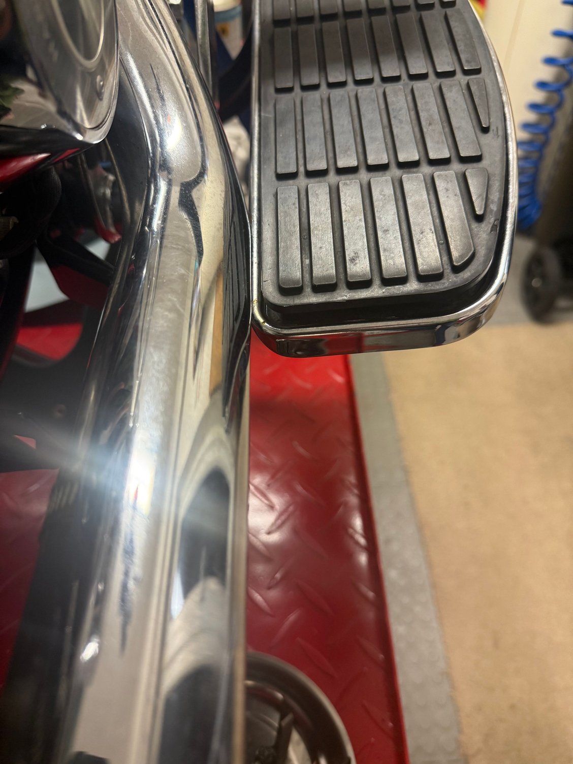

Guys,
Out of interest how close is the inside of the RH floorboard to your heat shields……this appears to close to be normal, but perhaps im wrong?
Only adjustment I can see is to slacken of the exhaust clamps at the heads and see if I can rotate slightly…..
Cheers

More likely the aftermarket pipes are a clunky fit. And yes your best compromise is to remove the exhaust, loosen the floorboard just a bit, install new exhaust gaskets
And tweak and slowly tighten with as much clearance as possible. In all compromises however good exhaust seal is a must.. after that your down to files, grinders and persuasion.
Cloud use a 50 to 80 thou thick set of washers between the floorboard brackets and the frame.

I agree with Rains2much. Space out the floorboard brackets. If you start messing around with the exhaust you open up a can of worms. Anything from broken exhaust studs in the cylinder heads to leaks.

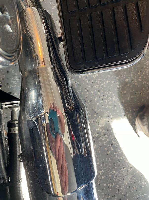

Here is a pic of my `89 Softail, the floorboards and exhaust system are original.
There is a head shield at the connection point of the header pipe and front muffler.

As long as the floorboard and the exhaust shields are not touching each other, it will be fine. Don't let OCD ruin your life.

I just noticed that it looks like a heat shield, underneath the pipe?

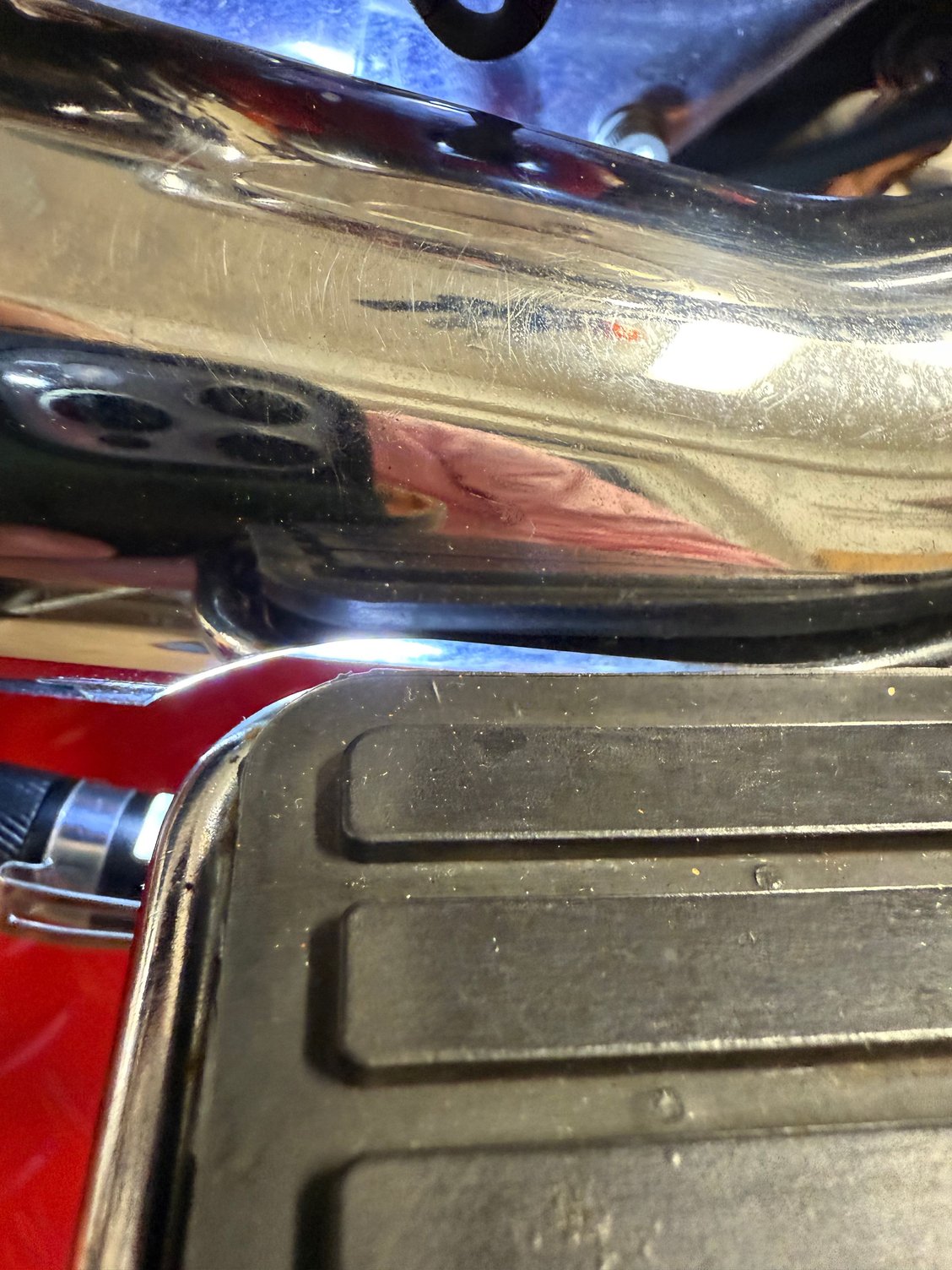

Cheers for th input guys - the OCD was indeed getting the better of me. What didn’t help way eyesight at almost 66 isn’t what it was.
I went to check out the floorboard bracket for options and noticed on closer inspection the heat shield had a cut out, to accommodate the board I assume,.
This photo probably describes better than I can.
Appreciate all the thoughts Guys.

Its deffo a correct oem heat shield for the model / year, but I might try to release and re tighten the bands….tbh I think I have worked it it now.
