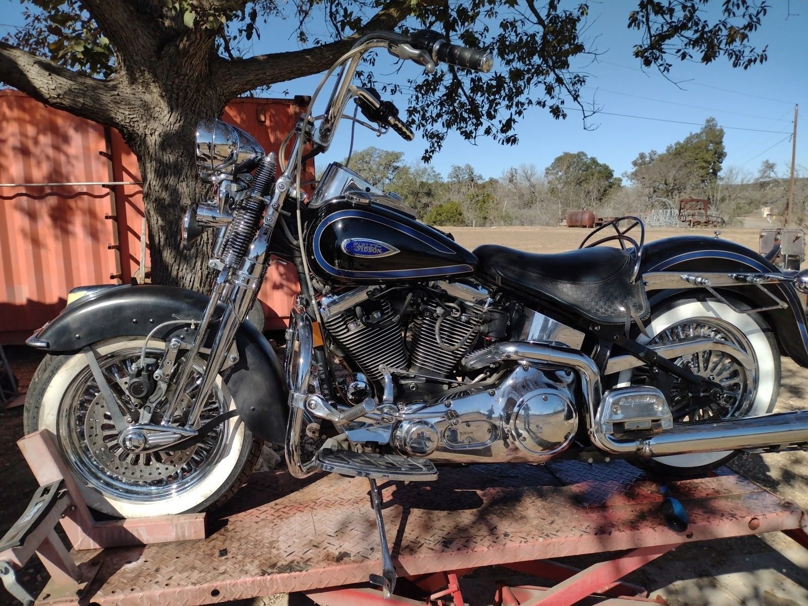

Just bought at 1998 Heritage softail springer. Looking for any guidance on where to get parts. I've looked at everything on eBay.

Well unsure sorry for being so vague I'm still in limbo of what I want to keep completely original. One question I do have is what year heritages are compatible with the 98?

Pretty much 84-99 with some parts differing like transmission stuff and some engine components.

Thank you. So far I've learned that the black and blue parts for the 98 are either really hard to come by or ridiculously expensive. I've been trying to find a front fender thats already painted but it looks like I'll have to get this one painted. I just ordered new risers cause the ones on it now are hideous. On the fence about going back original with the floorboards but still unsure. Also thinking of putting some long shots on it. I'd like to be able to atleast have all the original parts if for some reason i ever sell (which i have no plans of)

start here to at least get oem part numbers.
https://partsfinder.onlinemicrofiche...davidsonmc/286
When looking at the part numbers, check the price column, and if $0, means that parts are not longer in production,
and will need to run down New old stock parts that someone still has, used parts, or after market parts isntead.
Also keep in mind that Bike has taller bars than what can with it,so if regards to control cables off the bars, measure to know what lengths you needed if they need to be replaced. Also, figure out if bike is MM fuel injected, or carbed, since can get dialed in for after market sensors for the most part, that are as good and less expensive then the HD sensors instead. Hell, the soft saddle bag carriers are on the bike, and if you did not get the leather saddle bags with it, not hard to find oem or after market bags that will work with the carriers.
As for the only other thing that comes to mind (besides a gas tank that liner has peeled and rusted inside that you may need to clear up from bike sitting long time), is would do a compresssion test on cylinders, since without engine oil fogged for long storage, maybe some pitting on the valves and seats that may need some clean up as well.
In most case, such pitting is not deep so valves can be reground/valve seats re-cut, and while you have that apart, new valve steam seals as well.
So really, is this going to be a tear it to the ground apart and bring is back up to conditions is left the factory restore, kind of that, but not as deep, or more of just get it running and cleaned up, put on what is missing now, and just send it instead?

That's a nice looking bike! Clean her up. The spoked wheels will probably be a day or two worth of work but will look great when done.
Ask around and find a good painter for that fender. Not sure if its a reflection or a dent but if dent, there are guys out there that will get it out without harming the paint. Some of them are all set up to do the paintless dent repair and are skilled craftsman. Again, you just gotta ask around. My local dealer told me about the guy I used. That was two bike, three carr and countless referrals ago.
While not a dealer, I have had good luck with Dennis Kirk for a lot of items. Seems like you have to plan ahead to acquire Evo parts and keep some routine and "consumable" items on hand. Then there is the "this is good deal" part that you don't really need but seem to often come across. The hard part is "do I really need it"?
I have a cabinet and shelving unit full of maintenance parts, might need it parts, someday I will replace it parts, spare parts, and some "oh ****" parts. Then there is the attic in the garage, the wife don't know about that stash...
Good luck with the new bike. Post a few pics after you clean it up. It's amazing what a little soap, water, mothers chrome polish, and some wax will do. YD

I assume that's not the original front fender.
Did you ask the person where you bought it if they still had it?

Nice bike. Looks like a cool project that shouldn't take too much to get it looking and running good.

Original OEM parts its pretty much luck of the draw - ebay, craigslist, hell even some HD dealers tend to have the odd part still lying around in the inventory if you check with them.
Hardware / Bolts / Fasteners - You can get most things from companies like Vtwin Mfg, Drag Specialities or Colony Machine (my preference)
Items like motor parts, cases, clutch, gearbox parts etc - I typically use W&W cycles, J&P cycles, S&S, Baker etc.
Theres a vast catalogue of aftermarket replacement parts for these bikes but if you try to get every part NOS HD factory, thats more difficult.
