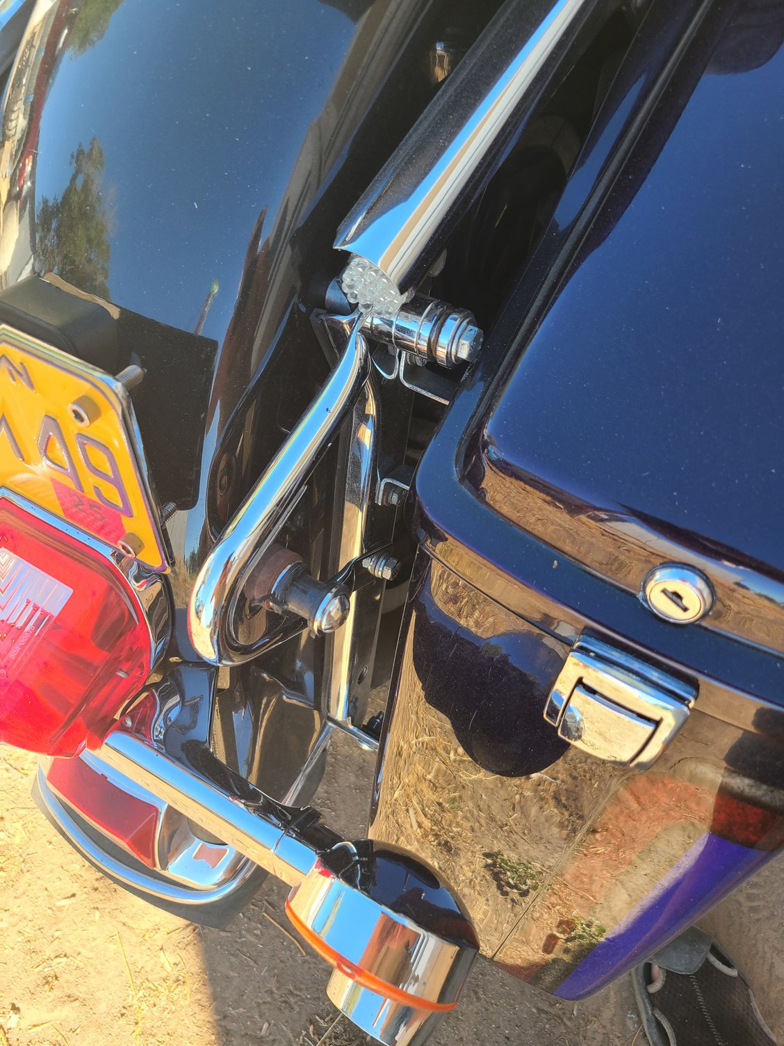

I have a detachable backrest with a luggage rack for my 95 RK that I bought from HD in the late 90s. I also have a detachable Tour Pack with hardware from an Ebay purchase that's most likely Chiwanese. Anything 93 to 08 should be a direct bolt on.

You can adapt the 97+ hardware to your earlier Evo. I did it for my 89 and 87. The spacing is different, but easy to fix.

On the 96 and older I believe you will need to use some spacers to center the mounting points for the late model QD accessories. I did i for my buddy and it worked fine.

The" early" detachable rack is 53107-96
goes back to `94
