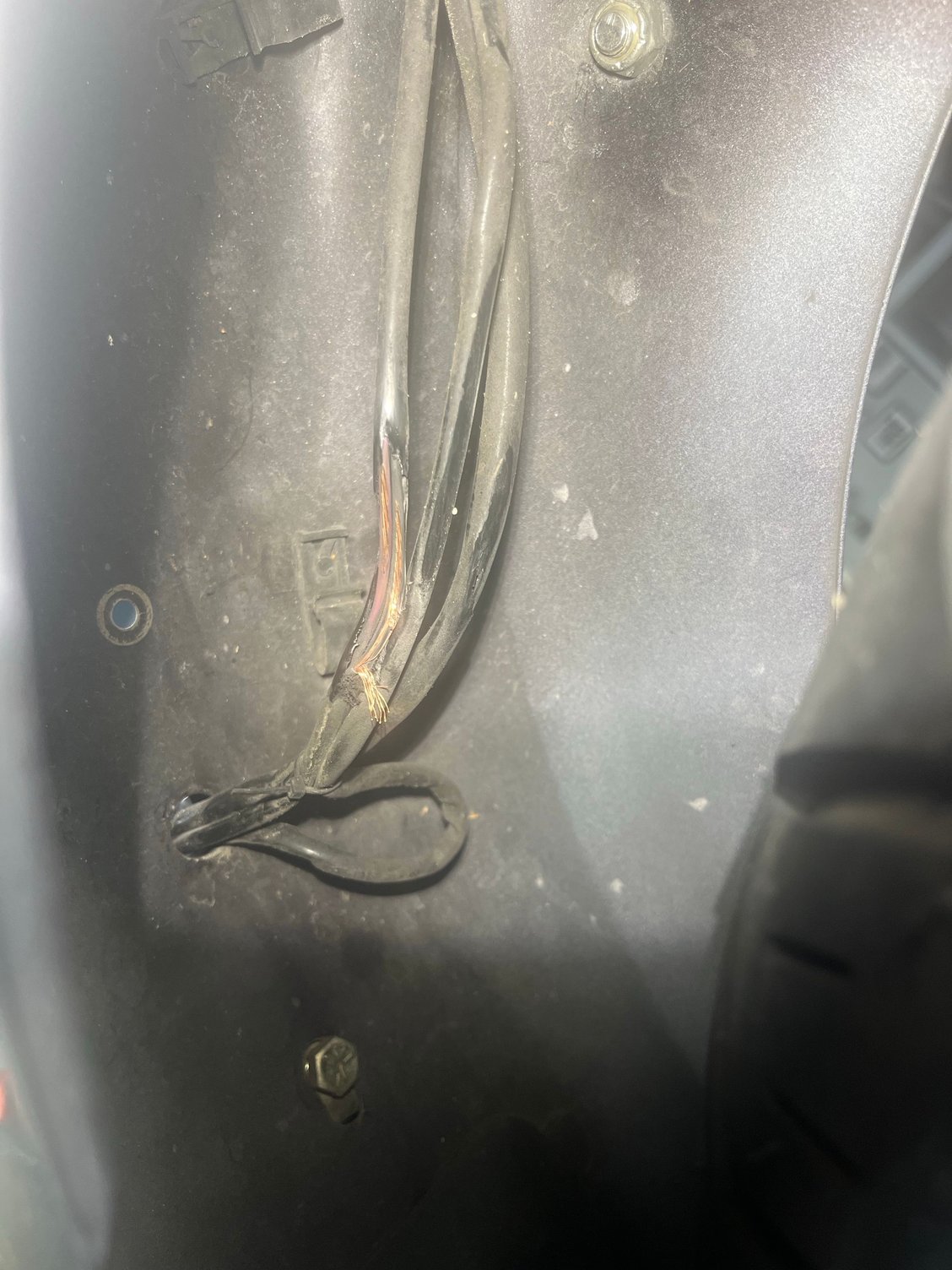

Previous owner left it like this \/ It was literally masking tape at each turn signal connection.. one of those L/R Brake Lite all in one tail light before.
Previous owner Nightmare wiring…. Taped up with masking tape  aftermarket turn signals

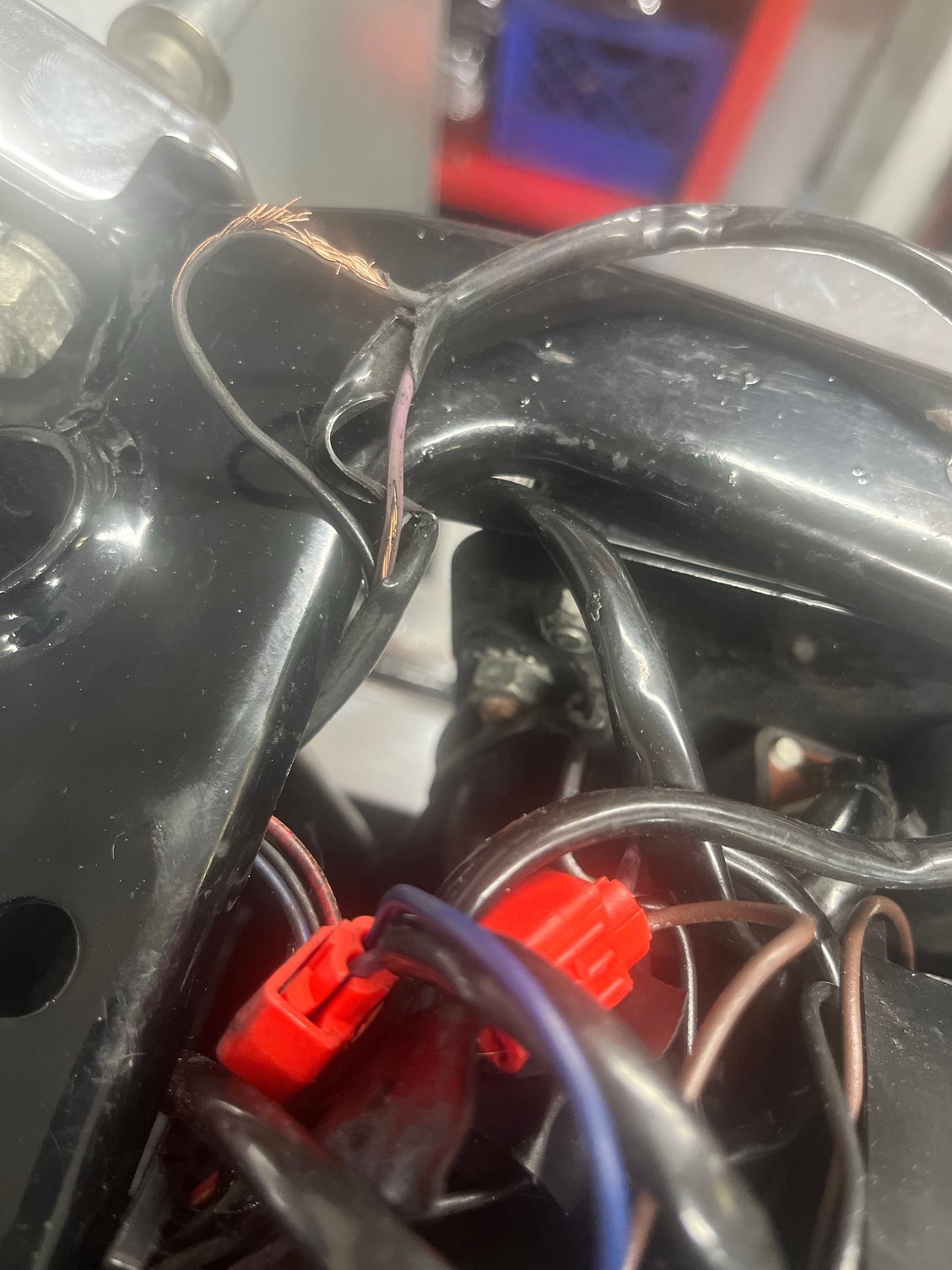

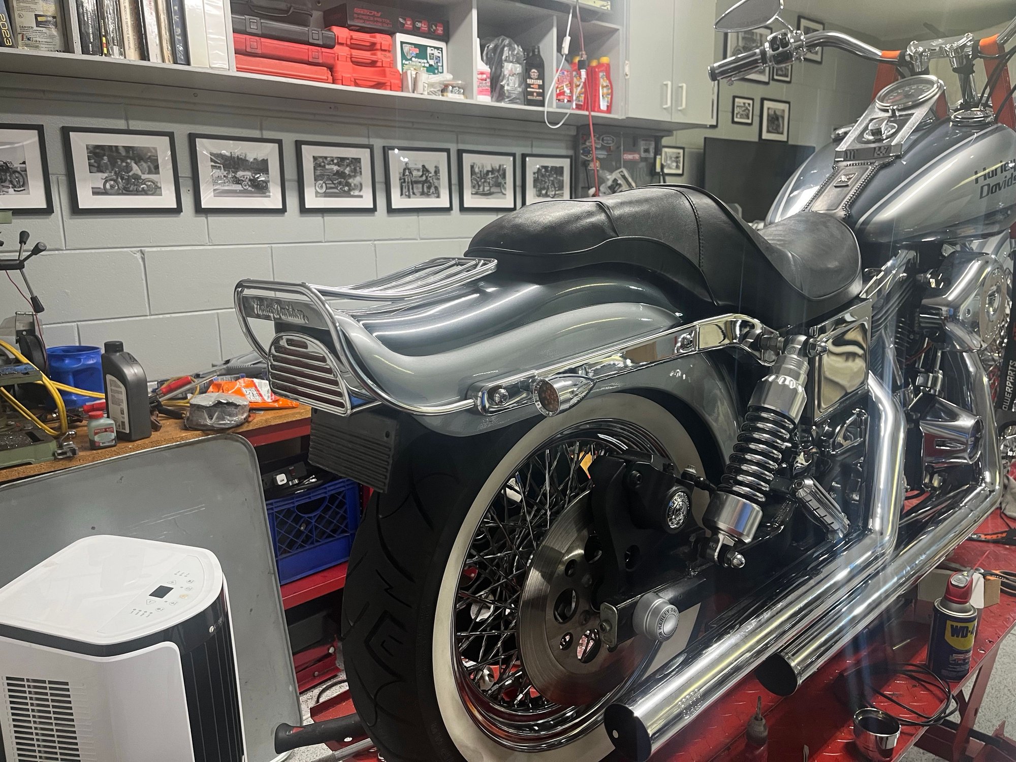

Looks nice now… but don’t work lol.
Looks nice now, new louvered tail light, new L/R turn signals that match the front… everything soldered and nicely shrink wrapped… but don’t work lol.
