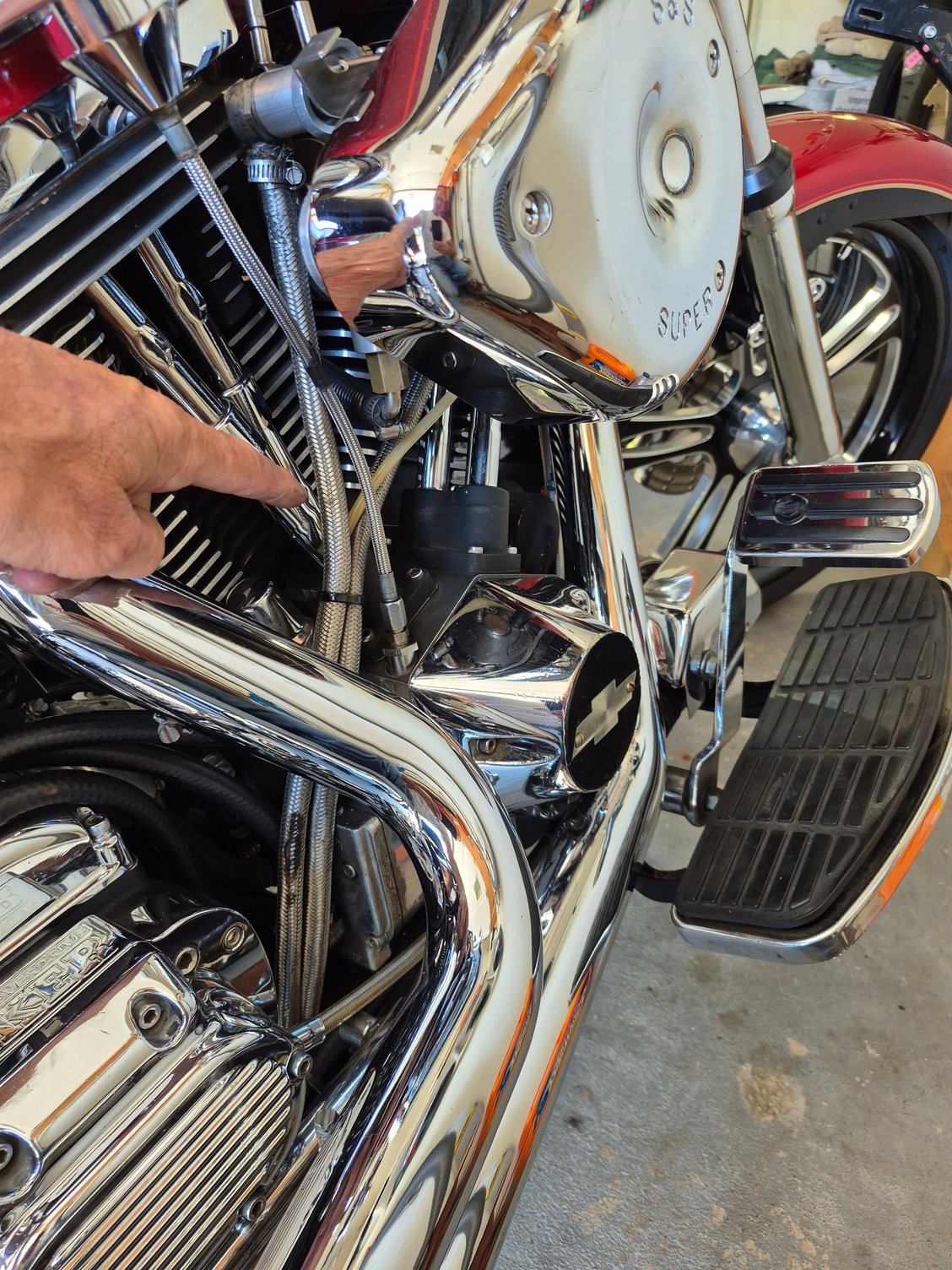

ok alot of contributers said the same on the iridiums. Damn $14 a piece but you learn as you go. As for the breather it has some sort of tube and what looks like a 3" round air filter that hangs down from the OEM carb. Oil level was brought into question. I will definatley use your advice thanks!

Sounds like somebody vented the breathers to atmosphere, which is good, but damn, that sounds like an awful big filter for that... I'm running 2 individual lines from each head breather down to the ground, no canister, no nothing.. If your umbrella valves are in any kind of decent shape and your return ports are not plugged, you shouldn't have any real issues and no need for such a big canister...
