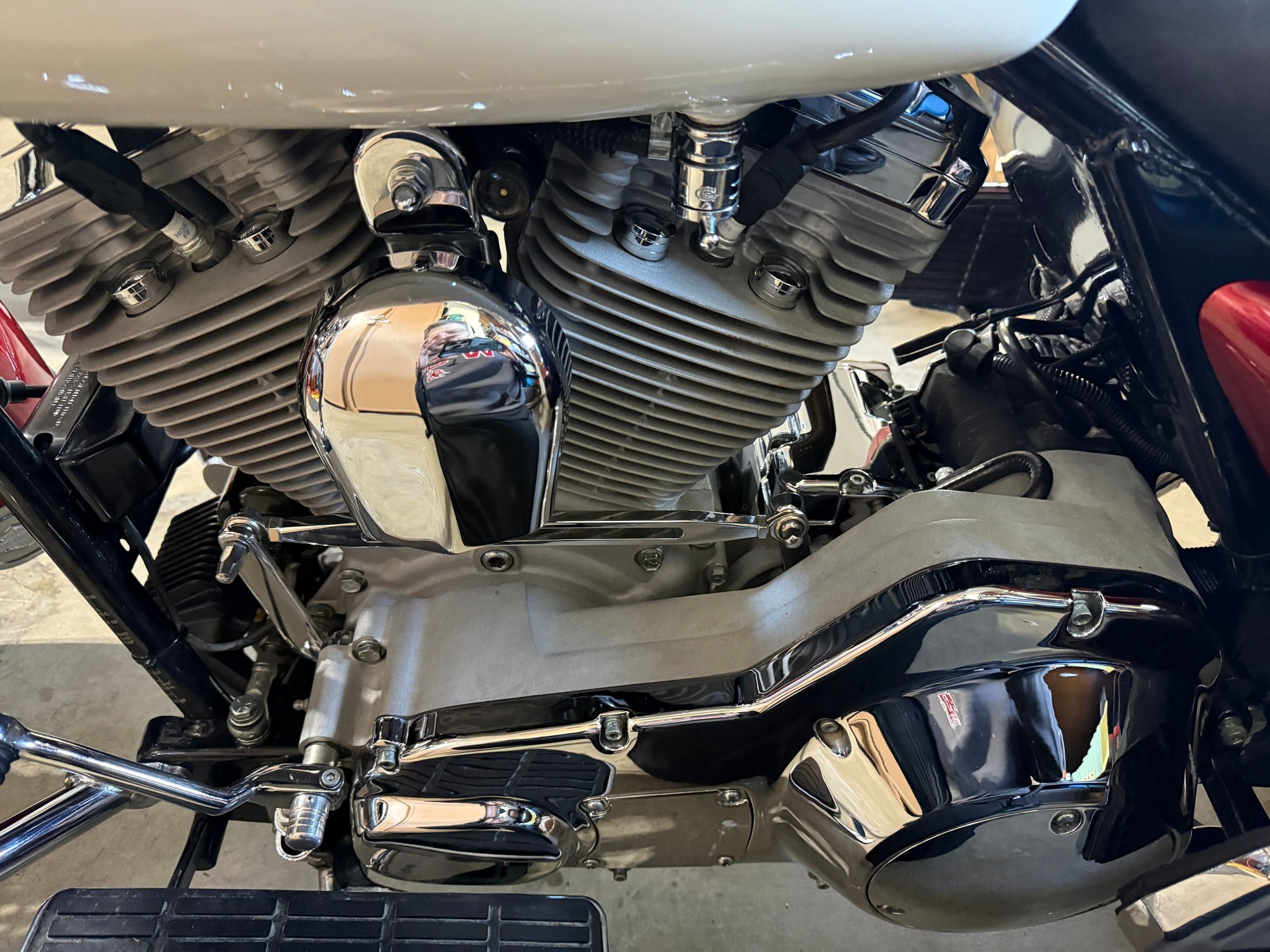

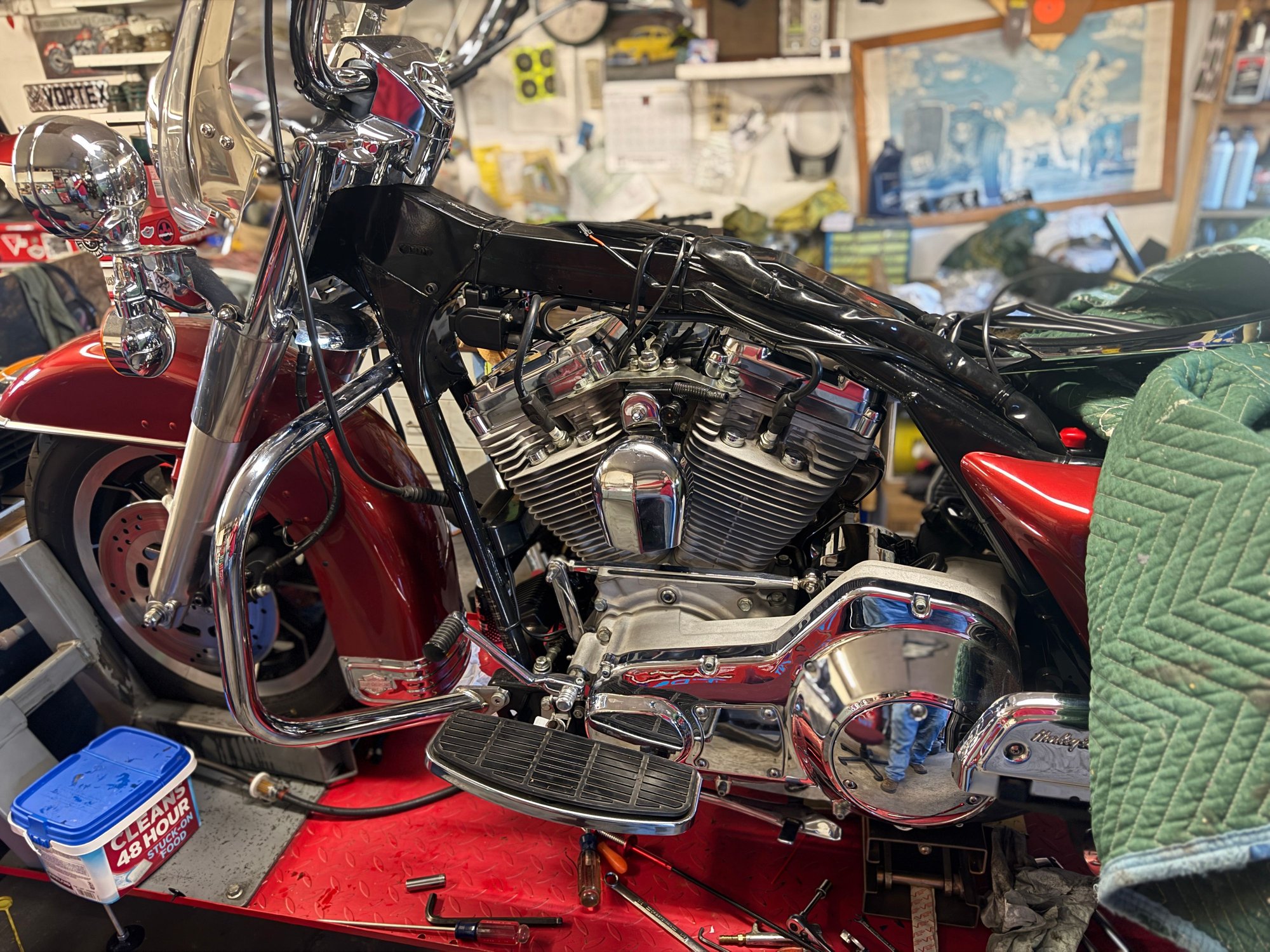

Well after a very rough winter for me. I finally got feeling well enough to finally tear into it. Found a few minor things i may have done wrong. Mostly the gaskets between the rocker boxes. One was twisted but wasn’t leaking there.
Pulled the rockers back off and inspected them to find some wear but not much. I did install the lockers. To just see if it quiets things down.
The front umbrella valve the “off brand” ones. It was totally dislodged. The rear wasn’t too far behind it.
One member I’ve chatted with off site said to check the oil passage from the top of the pushrod and flush it out really well. And to my surprise 3 out of 4 were plugged pretty well. One had a bunch of trash I’m hoping was from the prior setup. It was some waste looking stuff. So maybe with more oil going thru it will quiet things down. I did check the shaft and it didn’t look bad. No scarring and the bushings looked good. And the end play felt normal.
as per another recommendation I dropped the rev limiter down to 6k RPM from the 6500 where Hammer said to run it. Left Curve 3 on and turned the Voes back on as it definitely ran better with the Voes controlling retard.
Motors back together. Time to clean the bike up from sitting in the shop since Thanksgiving.

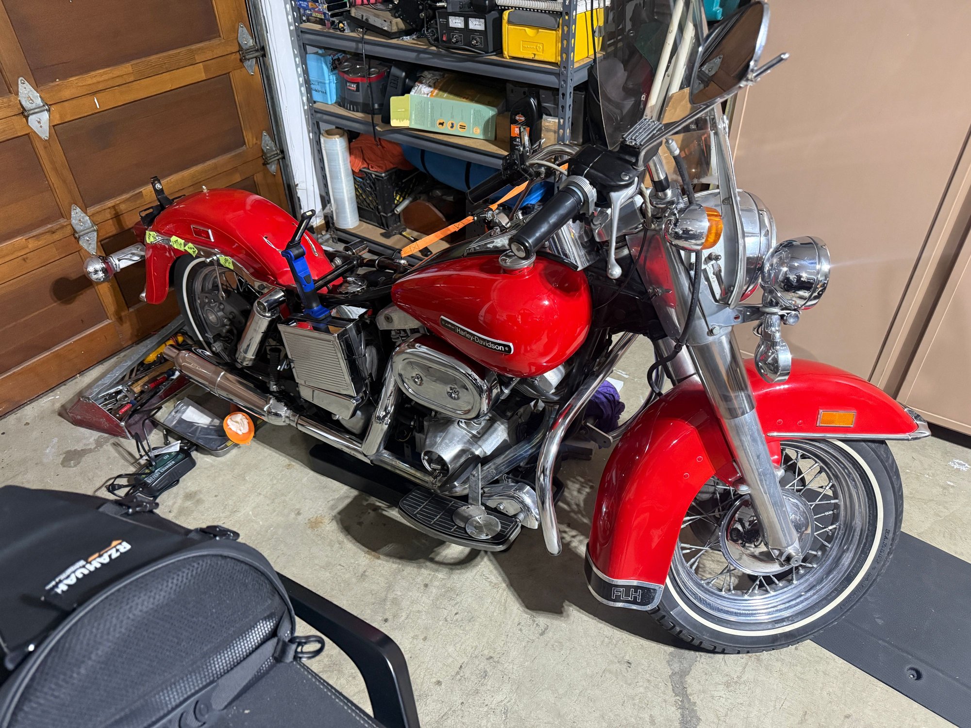

Gotta get it off the lift. Old man found this old. 1977 FL Shovelhead Electra Glide Sport. The great grand pappy to my 1998 King that left the factory as an Electra Glide Classic.
30 thousand some miles or so on the spedo anyway. Waiting on a set of points to see if it will fire up. Came out of the Tacoma Area.
Thing is,. pushing this thing around, this thing is tiny. It's like pushing a sportster around compared to my 98.
More to come on tbr old shovel.

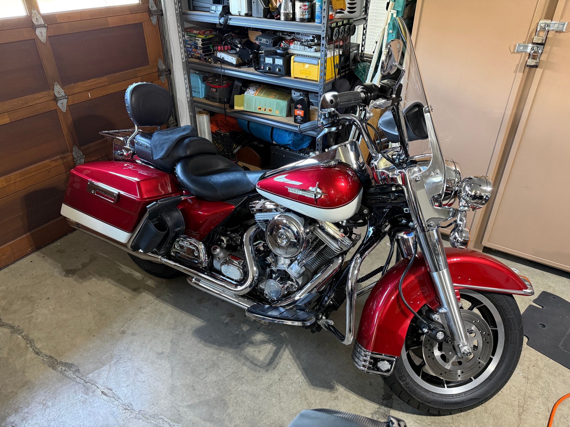

I think we can safely close this thread. Bikes back together, runs better. Top ends far quieter. I mean far quieter. Whether it was the plugged oil passage, the rocker lockers, or the Oem umbrella valves. It’s made a major difference.
Been riding my nimble 650 too much. I forgot how much of a pig the bike was. lol. Took me a few miles to shake off the cobwebs. But made a short run out the county highway, and jumped an exit on the freeway. It was too cold to go much further with what I was wearing.
if I have one issue remaining. It still acts like it’s a bit starved for fuel past 75. I didn’t crack the fuel cap thou. I will next time. But I did finally track down a local that I’ve ran into before and he said to drop a 190 in and maybe even a 195. 180s just too lean. So those are in order with a different shop this time. Hopefully get the right ones. He also recommended shimming the needle even though it’s the N65C. So I’ve got my old shim kit at the ready. Thankfully I swapped everything on the carb to Allen’s so I can pretty much do it all on the bike, just have to lift the tank a bit.
So I should hopefully now be good to go for a good while. Hopefully nice this weekend and I can clean all the oil residue off the jugs from the leak.
was told not to use brake clean, as it leaves a residue but to use acetone and a grey scotch pad. (Bare jugs) so I’ve got both so will see. I haven’t been too impressed with how I got them back from Hammer. They went too kind with the soda blast and left a lot of old gunk.
thanks again everyone.
