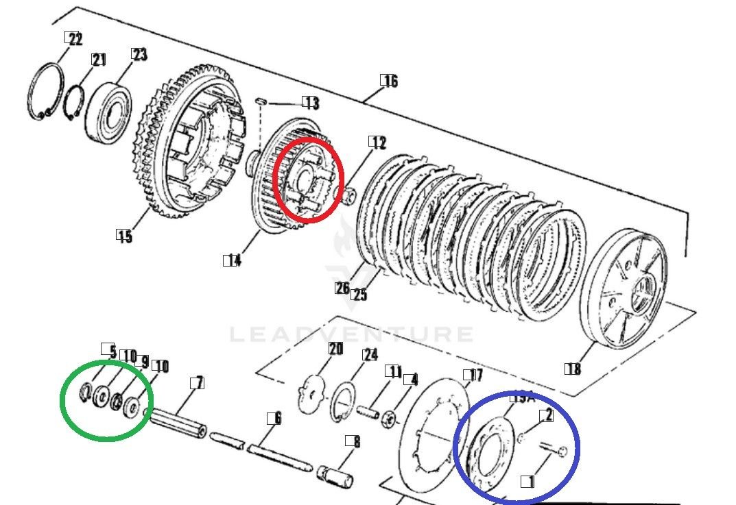

Are you following the cutch adjustment process called out in the factory service manual (diaphragm spring measurement, A, B, C, plate position etc) Blue circle in illustration.
Remove the right side cover on the transmission and inspect the throwout bearing (green circle).

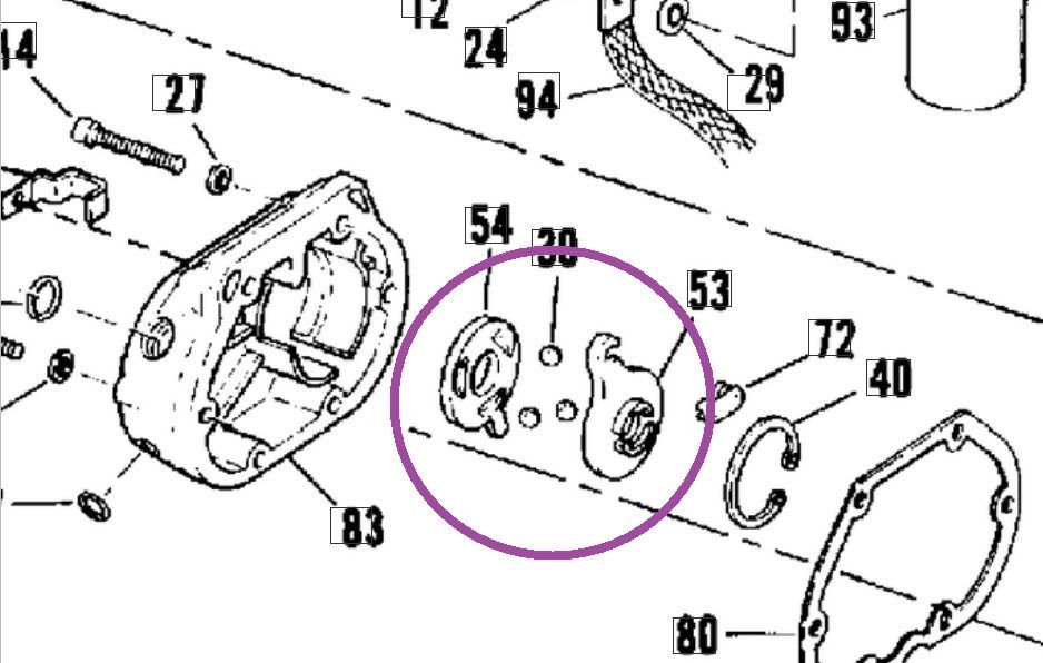

Also inspect the ***** and ramps (Purple circle).
When removing or installing the bolts that hold the adjustment plate/pressure plate, loosen and tighten them evenly, the posts on the hub are known to be a weak point (Red circle).

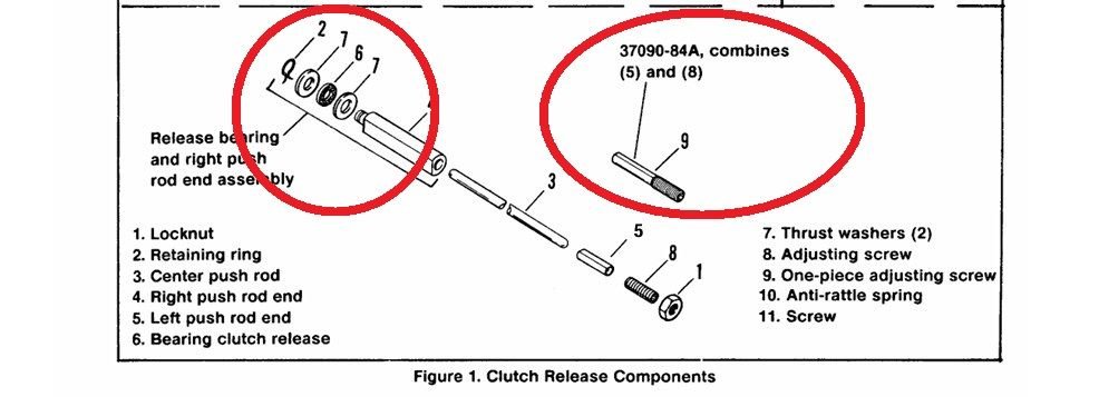

This type of damage can occour when the clutch is adjusted too tight, it causes the pushrod ends to eat into each other.
Replace the end that goes through the plate with part number 37090-84A, it is an upgraded design.
Also replace the throwout bearing (item6) and the washers (item 7), in addition to any parts you found worn/damaged.
