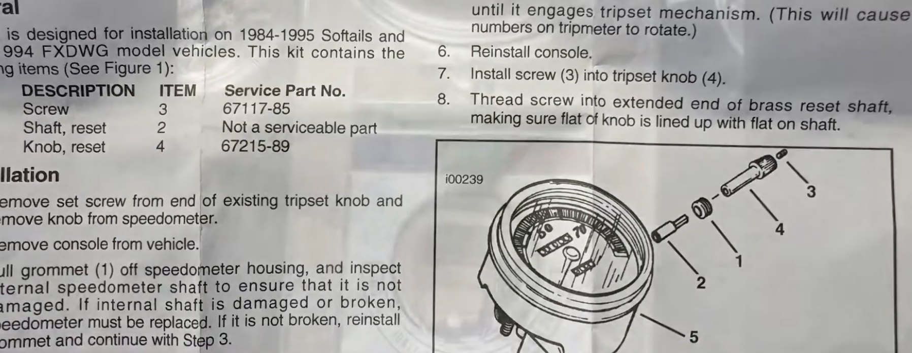

My speedometer is missing reference part number 2 so I can't attach and reset ****. Does anyone have one or know where I can get one?
Thanks!

I have a similar issue but I still have part 2...the little screw is broken off in it so i can't attach the ****. I found evidence that the kit existed in the past but could not find one anywhere. I added a tighter fitting grommet to hold the **** on and kept riding.
If you find one...let me know!

Most likely will need to find a good used Speedometer.. eBay has a couple.. Maybe you can interchange parts to yours..
