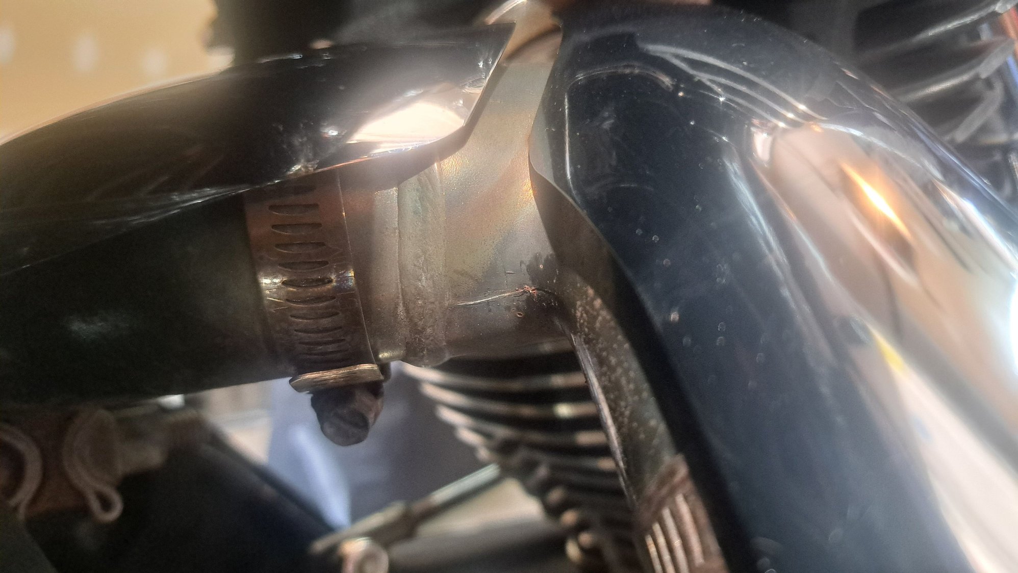

I have a 1989 FLHTC. it is currently in a 91 frame and has a S&S V111 powering it.
What head pipe years will fit it? The current pipes on it were an ebay purchase of new take off's from a 1991 FLHTC.
What is the year range which should fit? I find conflicting info.
The stock set I have currently has started to fracture.

If you are running original type exhaust, it'll have flanges at the mufflers. If so, '86 thru '94.
If the mufflers are straight pipe slide on, then anything from '95 thru '07. I think even later can be used but I'm not sure of the cutoff date.

Flanged pipes are gone thanks for the span
